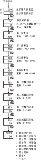

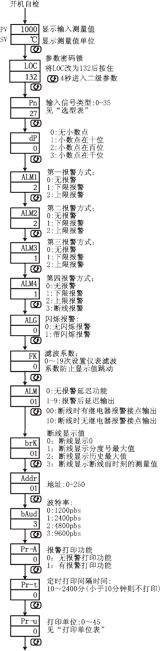

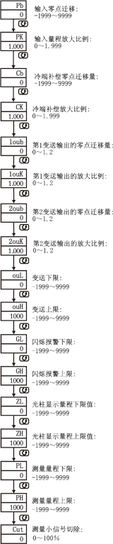

    ²ÎÊýÉ趨ÃÜÂëËø¶¨¡¢²ÎÊýÉèÖöϵçÓÀ¾Ã±£´æ£¬¾ß±¸²ÎÊý»Ö¸´³ö³§É趨¹¦ÄÜ¡£

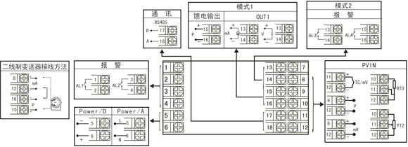

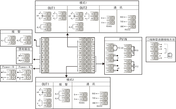

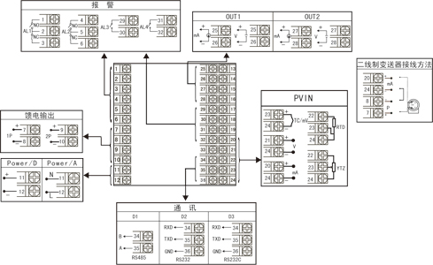

ÒDZí½ÓÏßͼ
    ¹æ¸ñ³ß´çΪA¡¢B¡¢C¡¢D¡¢E¡¢K¡¢L¡¢MÐͽÓÏßͼ
    ×¢£ººáÊúʽÒDZíºó¸Ç½ÓÏß¶Ë×Ó·½Ïò²»Ò»Ñù£¬¼ûʾÒâͼ1¡£
ͼһ
¹æ¸ñ³ß´çΪFÐͽÓÏßͼ
¹æ¸ñ³ß´çΪHÐͽÓÏßͼ
    ×¢£ºÉÏÊö½ÓÏßͼÖÐÔÚͬһ×é¶Ë×Ó±êÓв»Í¬¹¦ÄܵÄ,Ö»ÄÜÑ¡ÔñÆäÖÐÒ»ÖÖ¹¦ÄÜ¡£ÈçRS485ºÍRS232ÔÚͬһ×é½ÓÏß¶Ë×ÓÉÏ£¬Ö»ÄÜÑ¡ÔñÒ»ÖÖ¡£
