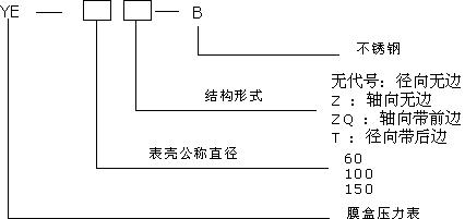

 ÐͺÅÃüÃû£º

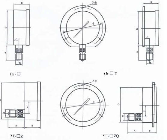

ÍâÐγߴ磺
ÐÍ   ºÅ
ÍâÐγߴç mm
A
B
C
D
d
d0
M
YE-60-B
31
32
14
60
14¡Á1.5
Y-60T-B
31
32
15
75
3.4
YE-60Z-B
30
32
0
YE-60ZQ-B
30
32
0
75
3.4
YE-100-B
44
45
18
100
20¡Á1.5
YE-100T-B
44
46
19
118
5.5
YE-100Z-B
43
45
34
YE-100ZQ-B
43
45
44
118
5.5
YE-150-B
47
19
149
20¡Á1.5
YE-150T-B
48
20
165
5.5
YE-150Z-B
51
47
55
YE-150ZQ-B
51
47
55
165
5.5
