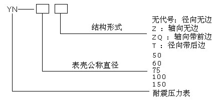

ÄÍÕðѹÁ¦±íÐͺÅÃüÃû£º

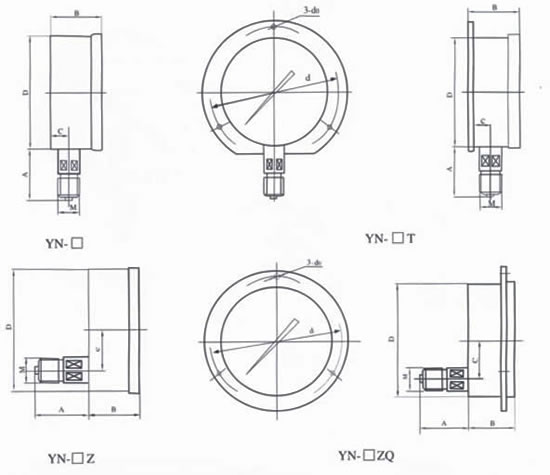

ÄÍÕðѹÁ¦±íÍâÐͰ²×°³ß´ç£º
ÐͺÅ
ÍâÐγߴç mm
A
B
C
D
d
d0
M
YN-50
29
24
9
G1/4
YN-50T
29
28
11
60
3.4
YN-50Z
29
24
0
YN-50ZQ
29
24
0
60
3.4
YN-60
31
32
14
60
   14X1.5
YN-60T
31
32
15
75
3.4
YN-60Z
30
32
0
YN-60ZQ
30
32
0
75
3.4
YN-75
24
30
12
75
YN-75T
24
30
12
90
5.5
YN-75Z
24
30
0
YN-75ZQ
24
30
0
90
5.5
YN-100
44
45
18
100
20X1.5
YN-100T
44
46
19
118
5.5
YN-100Z
43
45
34
YN-100ZQ
43
45
44
118
5.5
YN-150
47
19
149
20X1.5
YN-150T
48
20
165
5.5
YN-150Z
51
47
55
YN-150ZQ
51
47
55
165
5.5
