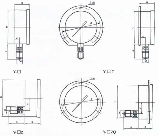

²úÆ·Ãû³Æ£º HY-YTUÐÍÄÍÁòѹÁ¦±í
ÐÍ ºÅ£º HY-YTUÐÍ
ÄÍÁòѹÁ¦±í
HY-YTU-100S HY-YTU-150S
²»Ðâ¸ÖÄÍÁòѹÁ¦±í£¬¹ã·ºÓ¦ÓÃÓÚʯÓÍ¡¢»¯¹¤µÈÐÐÒµ¡£ÄÜÔÚ¶Ô¹¤×÷»·¾³¸¯Ê´»ò¹¤ÒÕÎÀÉúÒªÇó½Ï¸ßµÄ³¡ºÏÖУ¬²âÁ¿¸÷ÖÖº¬ÓÐÁò»¯Çâ¡¢Á×ËáµÈÁ÷Ìå½éÖʵÄÕýѹ¡¢¸ºÑ¹»òÕý¸ºÑ¹¡£

¼¼Êõ²ÎÊý£º
ÐͺÅ
½á¹¹ÐÎʽ
¾«È·¶È%
²âÁ¿·¶Î§  MPa
YTU-100S
YTU-100TS
YTU-100ZS
YTU-100ZQS
¾¶ÏòÎÞ±ß
¾¶Ïò´øºó±ß
ÖáÏòÎÞ±ß
ÖáÏò´øÇ°±ß
¡À1.6
-0.1¡«0;-0.1¡«0.06;-0.1¡«0.15;
-0.1¡«0.3;-0.1¡«0.5;-0.1¡«0.9
-0.1¡«1.5;-0.1¡«2.4;
0¡«0.16;0¡«0.25;0¡«0.4;0¡«0.6;0¡«1.0;0¡«1.6
0¡«2.5;0¡«4.0;0¡«6.0;0¡«10;0¡«16
0¡«25;0¡«40;0¡«60
YTU-150S
YTU-150TS
YYU-150ZS
YTU-150ZQS
¾¶ÏòÎÞ±ß
¾¶Ïò´øºó±ß
ÖáÏòÎÞ±ß
ÖáÏò´øÇ°±ß
ÒDZíÖ´Ðбê×¼£ºGB/T1226-2001£¬Q/320211  DGH01-2003
È«²»Ðâ¸ÖѹÁ¦±íʹÓù¤×÷ζȣº-40¡æ~70¡æ£»
È«²»Ðâ¸ÖÄÍÕðѹÁ¦±íʹÓù¤×÷ζȣº-25¡æ~70¡æ
¹¤×÷»·¾³Õñ¶¯ÆµÂʲ»´óÓÚ25Hz£¬Õñ·ù²»´óÓÚ1mm
ÐÍ   ºÅ
ÍâÐγߴç mm
A
B
C
D
d
d0
M
YTU-100S
44
45
18
100
20¡Á1.5
YTU-100TS
44
46
19
118
5.5
YTU-100ZS
43
45
34
YTU-100ZQS
43
45
44
118
5.5
YTU-150S
47
19
149
20¡Á1.5
YTU-150TS
48
20
165
5.5
YTU-150ZS
51
47
55
YTU-150ZQS
51
47
55
165
5.5
