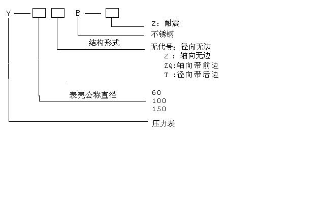

ÐͺÅÃüÃû:

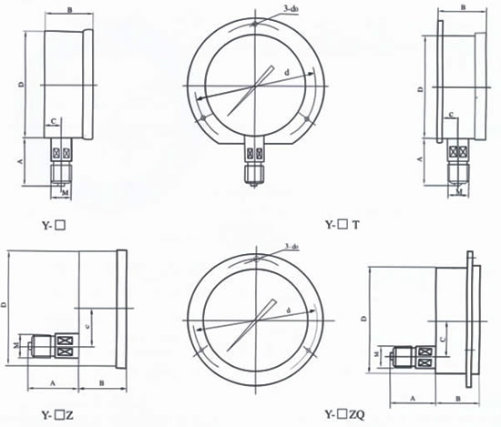

ÐÍ   ºÅ
ÍâÐγߴç mm
A
B
C
D
d
d0
M
Y-60B
31
32
14
60
14¡Á1.5
Y-60TB
31
32
15
75
3.4
Y-60ZB
30
32
0
Y-60ZQB
30
32
0
75
3.4
Y-100B
44
45
18
100
20¡Á1.5
Y-100TB
44
46
19
118
5.5
Y-100ZB
43
45
34
Y-100ZQB
43
45
44
118
5.5
Y-150B
47
19
149
20¡Á1.5
Y-150TB
48
20
165
5.5
Y-150ZB
51
47
55
Y-150ZQB
51
47
55
165
5.5
