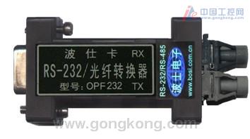

Ò»¡¢ÓÃ;
²¨Ê˵ç×ÓµÄOPF232ÎÞÔ´RS-232ËÜÁϹâÏËת»»Æ÷ÓÃÓÚʵÏÖRS-232µÄËÜÁϹâÏË´«Êä¡¢ÌØ±ðÊÇÖ»ÓÐÊÕ£¨RXD£©¡¢·¢£¨TXD£©¡¢µØ£¨GND£©Èý¸ùÏßµÄRS-232¿ÚµÄÎÞÔ´ËÜÁϹâÏË´«Êä,±ÈÈçÒDZíµÄRS-232¿Ú¡£²¨Ê˵ç×Ó·¢Ã÷ºÍÊ×´´ÁËÎÞÐëÍâ½ÓµçÔ´µÄRS-232/¹âÏËת»»Æ÷¡¢ÊÇÊÀ½çÉÏ×îСµÄ¹âÏËת»»Æ÷¡£
²¨Ê˵ç×ÓµÄOPF485ÓÐÔ´RS-485/422/232ËÜÁϹâÏËת»»Æ÷ÓÃÓÚʵÏÖRS-485¡¢RS-422»òÕßRS-232µÄËÜÁϹâÏË´«Êä¡£²¨Ê˵ç×Ó·¢Ã÷ºÍÊ×´´ÁËÊÀ½çÉÏ×îСµÄRS-485/232/ËÜÁϹâÏËת»»Æ÷¡£
²¨Ê˵ç×Ó¹âÏËת»»Æ÷ÓµÓÐϵÁÐרÀû£ºZL03335086¡¢ZL03335087¡¢ZL03335088£¬·Âð±Ø¾¿£¡
OPF232¡¢OPF485Ö÷ÒªÓÃÓÚ´®¿ÚÐźŵĶ̾àÀ루20Ã×ÄÚ£©µÄËÜÁϹâÏËͨÐÅ£¬¾ßÓп¹ÕÛ¶Ï¡¢Ò×ÓÚÁ¬½Ó¡¢¸ß¸ôÀëµçѹ¡¢·Àµç´Å¸ÉÈÅ¡¢¿¹À×»÷µÈÓŵ㡣
¶þ¡¢Ó²¼þ°²×°
 OPF232ÐÍRS-232/¹âÏËת»»Æ÷µÄÍâÐÎΪDB-9/DB-9ת½ÓºÐ´óС£¬ÆäÖÐDB-9(¿××ù)Ò»¶ËÖ±½Ó²åÔÚDB-9оRS-232Õë×ùÉÏ¡¢ÎÞÐëÍâ½ÓµçÔ´£¬Ê¹ÓÃÒ»¶ÔËÜÁϹâÏ˽ÓÍ·¡£
OPF485ÐÍRS-485/422/232/¹âÏËת»»Æ÷µÄÍâÐÎΪDB-25/DB-9ת½ÓºÐ´óС£¬ÆäÖÐDB-25(¿××ù)Ò»¶ËÅäÓнÓÏß¶Ë×Ӱ壬½ÓRS-485¡¢RS-422¡¢RS-232ÒÔ¼°5VµçÔ´£¬Ê¹ÓÃÒ»¶ÔËÜÁϹâÏ˽ÓÍ·¡£
OPFϵÁйâÏËת»»Æ÷ʹÓÃʱ·¢ËÍÆ÷Í·£¨Ç³»ÒÉ«£©Í¨¹ýËÜÁϹâÏ˽ӶԷ½µÄ½ÓÊÕÆ÷Í·£¨À¶É«£©¡£×¢Òâ±£³Ö¹âÏËת»»Æ÷µÄ¹âÏËÍ·µÄÇå½à£¬Èç¹û²»Á¬½ÓʱÇëÒ»¶¨½«ÓÃÏàÅäÌ×µÄÏðƤÈû×Ó¸Çס¡£
Èý¡¢ÐÔÄÜÌØµã
    ²¨Ê˵ç×ÓµÄOPF232ºÍOPF485ËÜÁϹâÏËת»»Æ÷×î¸ßËÙÂÊ115.2Kbps¡£ÎÞÐèÈκγõʼ»¯ÉèÖã¡¶ÀÓв¨ÊËÁãÑÓʱ×Ô¶¯ÊÕ·¢×ª»»¼¼Êõ£¬È·±£ÊʺÏËùÓÐÈí¼þ!È·±£½ÓÈýÏßÖÆRS-232¿ÚʱÎÞÐ빩µç£¡
