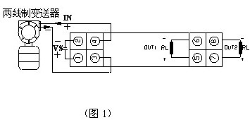

£ªÌáʾ1 £ºÇ°¶ËΪ2ÏßÖÆÒDZíʱ£¬½«²úÆ·¶¥Ã濪¹Ø°ÎÖÁ2wire¶Ë£¬È磨ͼ1£©

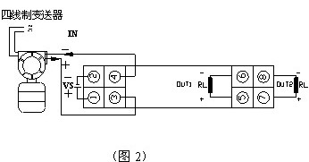

£ªÌáʾ2 £ºÇ°¶ËΪ3¡¢4ÏßÖÆÒDZíʱ£¬½«²úÆ·¶¥Ã濪¹Ø°ÎÖÁ3¡¢4wire¶Ë£¬È磨ͼ2£©
