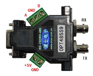

²¨Ê˵ç×ÓµÄOPT485S9³¬Ð¡ÐÍRS-232/485/µ¥Ä£¹âÏËת»»Æ÷¿ÉÒÔʵÏÖRS-232»òRS-485Ó뵥ģ¹âÏËת»»¹¦ÄÜ£¬²¢ÇÒ¿ÉÒÔÖ±½ÓÍâ²åDB-9ÕëRS-232¿Ú¡£×¨Àû²úÆ·£¬ÓµÓÐZL03335086ºÅÖйúרÀû¡£ÓÉÓÚ²ÉÓùâÏË×÷ΪͨÐÅ´«Êä½éÖÊ£¬¾ßÓи߸ôÀëµçѹ¡¢·Àµç´Å¸ÉÈÅ¡¢¿¹À×»÷µÈÓŵ㡣²¨Ê˹âÏËת»»Æ÷¹ã·ºÓÃÓÚ¸÷ÖÖ¹¤Òµ¹ý³Ì¿ØÖÆ¡¢·Ö²¼Êý¾Ý²É¼¯µÈ³¡ºÏ¡¢ÌرðÊʺϵçÁ¦ÏµÍ³×Ô¶¯»¯¡¢½»Í¨¿ØÖƵȲ¿ÃÅ¡£
¶þ¡¢Ó²¼þ°²×°
OPT485S9ÐÍRS-232/485/¹âÏËת»»Æ÷£¨µ¥Ä££©µÄÍâÐÎΪDB-9/DB-25ת½ÓºÐ´óС£¬ÆäÖÐDB-9(¿××ù)Ò»¶Ë¿ÉÒÔÖ±½Ó²åÔÚDB-9оRS-232Õë×ùÉÏ¡¢RS-485ÐźÅÏßÒÔ¼°Íâ½Ó5VµçԴʹÓòúÆ·ÉϵĽÓÏß¶Ë×Ó¡£²úƷʹÓÃÒ»¶ÔST¹âÏ˽ÓÍ·£¬ TX¹â·¢ËÍÍ·£¬ RX¹â½ÓÊÕÍ·±êÖ¾¼û²úƷͼ¡£
OPTϵÁйâÏËת»»Æ÷ʹÓÃʱ·¢ËÍÆ÷ͨ¹ý¹âÏ˽ӶԷ½µÄ½ÓÊÕÆ÷¡£×¢Òâ±£³Ö¹âÏËת»»Æ÷µÄST×ùµÄÇå½à¡¢Èç¹û²»Á¬½ÓʱÇëÒ»¶¨ÓÃÏàÅäÌ×µÄÏðƤÈû×Ó¸Çס¡£
Èý¡¢ÐÔÄÜÌØµã
²¨Ê˵ç×ÓµÄOPT485S9¹âÏËת»»Æ÷×î¸ßËÙÂÊ115.2Kbps¡£ÎÞÐèÈκγõʼ»¯ÉèÖã¡¶ÀÓв¨ÊËÁãÑÓʱ×Ô¶¯ÊÕ·¢×ª»»¼¼Êõ£¬È·±£ÊʺÏËùÓÐÈí¼þ! OPT485S9µÄDB-9¿×¶Ë¿ÉÒÔÖ±½ÓÍâ²åPC»úµÄDB-9ÕëRS-232¿Ú£¨Õë×ù£©¡¢Ö»Óõ½¼ÆËã»úµÄRXD-2¡¢TXD-3¡¢GND-5Èý¸öÐźÅÏß¡£RS-485ÐźÅΪA¡¢GND¡¢BÈý¸ö½ÓÏß¶Ë×Ó£¨Èçͼ£©¡£

½Ó¿Ú DB-9¿×RS-232£¨Íâ²åÕë×ù£©
´«Êä½éÖÊ Ë«¶àÄ£¹âÏË ½ÓÏß¶Ë×ÓµÄRS-485ÒÔ¼°µçÔ´
ͨÐÅ
·½Ê½ RS-232/RS-485 ³ß´ç¼°ÖØÁ¿ DB-9/25ת½ÓÍ·´óС¡¢80¿Ë
Òì²½RS-232 ´«Êä¾àÀë 40Km£¨µ¥Ä££©
¹â²¨³¤ 1310nm£¨µ¥Ä££© ÊÊÓùâÏË 50/125¡¢62.5/125¡¢100/140um
ËÄ¡¢ÍâÐÎͼ
²¨Ê˵ç×ÓÅäÌ×Ìṩ¸÷ÖÖ³¤¶Èµ¥Ð¾¡¢Ë«Ð¾¹âÏËÒÔ¼°ST¡¢FC¡¢SC½ÓÍ·¡£ ×¢ÒâRS-232ÓëRS-485²»ÒªÍ¬Ê±Ê¹Óá£OPT485S9²úÆ·ÅäÌ×ÓÐ5VµçÔ´£¨4.5 Vµ½5.5V£©£¬²úÆ·¹¦ºÄСÓÚ100mA¡£
