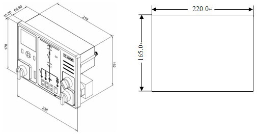

5.1 ASD200¡¢ASD300

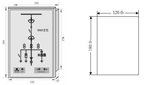

5.2 ASD100

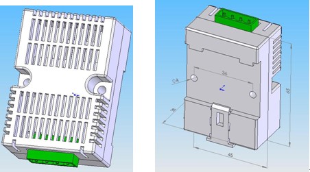

5.3 ÎÂʪ¶È´«¸ÐÆ÷£¨ÅäÌ׸½¼þ£©

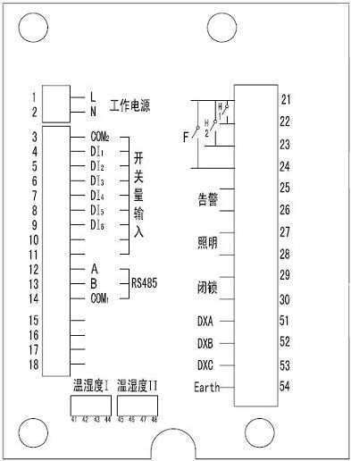

6.1 ASD300
6.2 ASD200

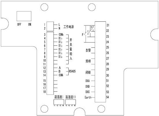

 6.3 ASD100
