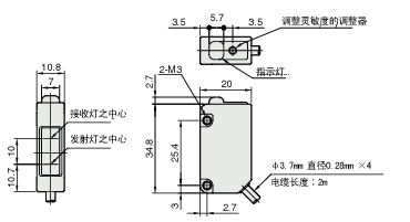

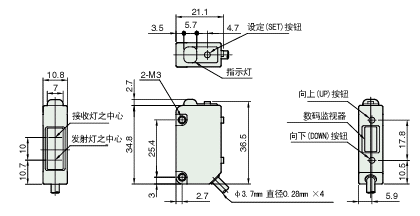

PZ-V11(P)/PZ-V31(P)
PZ-V11/PZ-V31 ¹âµç´«¸ÐÆ÷ ³ß´ç
PZ-M11(P)/PZ-M31(P)
PZ-M11/PZ-M31¹âµç´«¸ÐÆ÷ ³ß´ç

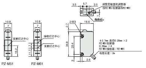

PZ-M51(P)/PZ-M61(P)
PZ-M51/PZ-M61 ¹âµç´«¸ÐÆ÷ ³ß´ç

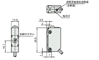

PZ-V71
PZ-V71 ¹âµç´«¸ÐÆ÷ ³ß´ç

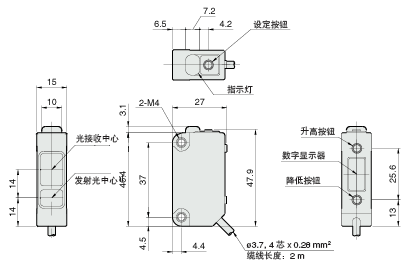

PZ-M71
PZ-M71 ¹âµç´«¸ÐÆ÷ ³ß´ç
