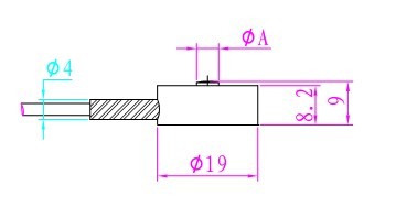

µçÀ³ߴç Cable size
¦µ2.5¡Á3000mm
ÍâÐγߴ磺
