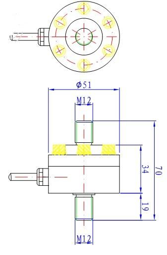

²úÆ·Ãû³Æ£º À­Ñ¹Ê½²âÁ¦/³ÆÖØ´«¸ÐÆ÷
ÐÍ ºÅ£º PLD204KM
À­Ñ¹²âÁ¦´«¸ÐÆ÷,À­Ñ¹Á¦´«¸ÐÆ÷,²âÁ¦´«¸ÐÆ÷,ѹÁ¦´«¸ÐÆ÷,À­Á¦´«¸ÐÆ÷
ÌØµãÓëÓÃ;£º
²»Ðâ¸ÖÀ­Ñ¹Ê½½á¹¹¡£½á¹¹¼òµ¥£¬ÐÔÄܿɿ¿¡£¹ã·ºÓ¦ÓÃÓÚ¹¤Òµ¹ý³ÌÁ¦µÄ¿ØÖƼ°ÅäÁÏ¿ØÖÆÏµÍ³¡£
¼¼Êõ²ÎÊý£º
¶î¶¨ÔغɠRated capacities(Emax)
100¡¢200¡¢300¡¢500¡¢1000¡¢2000kg
Êä³öÁéÃô¶È Rated output
2.0¡À10%mV/V
×ÛºÏÎó²î Total error
0.05%F.S
·ÇÏßÐÔ Non-linearity
0.05%F.S
Öͺó Hysteresis
0.05%F.S
ÖØ¸´ÐÔ Repeatability
0.05%F.S
Èä±ä(30·ÖÖÓ)Creep(30min)
0.05%F.S
ÁãµãÊä³öZero balance
¡À2%F.S
ÁãµãÎÂ¶ÈÆ¯ÒÆ Temperature effect on zero
¡À0.05%F.S/10¡æ
ζÈÁéÃô¶ÈÆ¯ÒÆ Temperature effect on out
¡À0.05%F.S/10¡æ
ÊäÈë×迹 Input resistance
385¡À10¦¸
Êä³ö×迹 Output resistance
350¡À5¦¸
¾øÔµµç×è Insulation resistance
¡Ý5000M¦¸/100DC
¶È²¹³¥·¶Î§ Compensated Temperature range
-10¡«+50¡æ
¹¤×÷ζȷ¶Î§ Operation Temperature range,
-35~+65 ¡æ
°²È«¹ýÔØ Maximum safe overload
120 %F.S
¼«ÏÞ¹ýÔØ Ultimate overload
200 %F.S
ÍÆ¼ö¼¤Àøµçѹ Excitation,recommend
5-10V DC
×î´ó¼¤Àøµçѹ Excitation,maximum
15V DC
·À·âµÈ¼¶ Protection Class
IP67
µçÀ³ߴç Cable size
¦µ2.5¡Á3000mm
