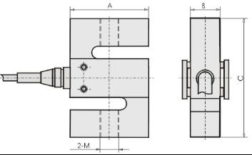

ÍâÐγߴç
Á¿³Ì(kg)
A
B
C
M
1~5
70
10
60
M6
10~50
50.8
12.7
63.5
M8
100
50.8
19.1
76.2
M12
150~500
64
23
82
M12
