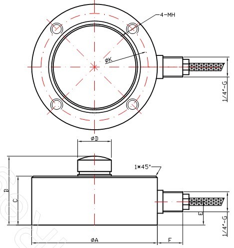

²úÆ·Ãû³Æ£º Ô²°åʽ³ÆÖØ/²âÁ¦´«¸ÐÆ÷
ÐÍ ºÅ£º PLD204B
ÂÖ·ùʽ³ÆÖØ´«¸ÐÆ÷¡¢Ô²°åʽ²âÁ¦´«¸ÐÆ÷¡¢Ô²°åʽ³ÆÖØ´«¸ÐÆ÷
ÐͺţºPLD204B                         Á¿³Ì£º0.5¡¢1¡¢2¡¢3¡¢5¡¢10¡¢20¡¢30¡¢50¡¢100£¨t£©
°²È«¹ýÔØ·¶Î§£º150%                ¼«ÏÞ¹ýÔØ·¶Î§£º200%
ÌØµã¼°ÓÃ;£º
²ÉÓò»Ðâ¸Ö¸Ö²ÄÖÊ£¬µÍÍâÐ͸ã²âÏòÁ¦£¬¾«¶È¸ß£¬²ÉÓýºÃÜ·â·À»¤´¦Àí
Ó¦ÓÃÓÚ¹¤Òµ³ÆÖØÏµÍ³Á¦µÄ²âÁ¿
½ÓÏß·½Ê½£º
ºì ÊäÈë+     ºÚ ÊäÈë-      °× Êä³ö-      ÂÌ Êä³ö+

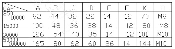

ÍâÐγߴ磺
