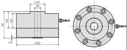

ÍâÐγߴçͼ(mm)£º
Á¿³Ì(t)
1~5
10
20
25
30
H1
67
80
85
H2
46
53.8
53.8
H3
34
41
47
M
M16¡Á1.5
M32¡Á1.5
D1
32
41
41
D2
105
121
121
