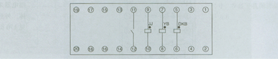

3.ÄÚ²¿½ÓÏß

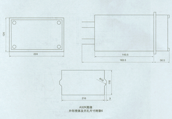

4.ÍâÐμ°¿ª¿×³ß´ç
¼ÌµçÆ÷²ÉÓÃA32K¿ÇÌ壬ÍâÐγߴ硢°²×°¿ª¿×ͼ¡£
