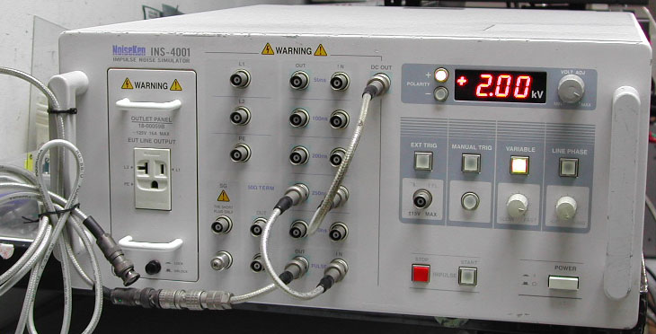

Âö³åÔëÉùÄ£ÄâÆ÷(Impulse Noise Simulator)ÊÊÓÃÓÚÆÀ¼Û²úÆ·EMC¸ßƵ´«µ¼ÔÝÌ¬ÌØÐÔ
  1. Âö³å¿í¶È : 50ns, 100ns, 200ns, 250ns, 400ns,and any combination there of, maximum width 1¥ìs or 10ns(the shortest connection)
  2. Âö³åÉÏÉýʱ¼ä : СÓÚ1ns
  3. Âö³åµçѹ : ×î´ó 2.00KV
  4. Âö³å¼«ÐÔÑ¡Ôñ : Õý¡¢¸º
  5. Êä³ö×迹 : 50ohm
  6. Íâ½Ó : 10ms TTL/Open collector negative logic
  7. ΢µ÷ : 10ms¡À10% ~ 100ms-0ms/+80ms
  8. Line : 50Hz or 60Hz, Injection phase angle : 0~359 ¶È
  9. Power capaciry of equipment under test : AC 240V, DC 60V, Single phase, 16A
