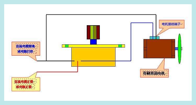

½ÓÏß·½·¨Èçͼ
750¡Á400
(1)Ö±Á÷µ÷ËÙ¿ª¹ØÓÐÈý¸ö½ÓÏß¶Ë
(2)ºÚÏßÓëÖ±Á÷µçÔ´¸º¼«Ïà½Ó¡¢Ê¹ÓÃµçÆ¿Ê±ÓëµçÆ¿¸º¼«Ïà½Ó
(3)ºìÏßÓëÖ±Á÷µçÔ´Õý¼«Ïà½Ó¡¢Ê¹ÓÃµçÆ¿Ê±ÓëµçÆ¿Õý¼«Ïà½Ó
(4)À¶ÏßÓë¸ºÔØ¶Ë£¨£«£©Ïà½Ó
(5)¸ºÔصĸº¶Ë£¨£­£©ÓëÖ±Á÷µçÔ´¸º¼«¡¢Ê¹ÓÃµçÆ¿Ê±ÓëµçÆ¿¸º¼«Ïà½Ó
¼ì²é½ÓÏßÕýÈ·ºó·½¿Éͨµç
˳ʱÕëµ÷½ÚÐýŤ,Õâʱ¿ÉÌý¼û»ò¸Ðµ½µ÷ËÙ¿ª¹ØÄÚ²¿ÓÐÇå´àµÄÉùÒô,ÕâÕýÃ÷ÄÚ²¿¿ª¹ØÒѽÓͨ
Ëæ×ÅÐýŤµÄ½Ç¶È²»¶ÏµÄ¼Ó´ó¿ØÖƵç»úתËÙ²»¶ÏµÄ¼ÓËÙ,µ±°ÑÐýŤÐýµ½µ×ʱµç»úµÄËÙ¶ÈÒ²´ïµ½×î¸ßËÙ.
×¢Òâ:½ÓÏß·½Ê½Êô²¢Áª£¬µç»úµÄ¸º¶Ë£¨£­£©ÓëÖ±Á÷µçÔ´µØÏß»òµçÆ¿´òÌúÏà½Ó¡£
