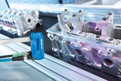

    SICK´«¸ÐÆ÷ÍÆ³öȫжþάÌõÂëÔĶÁÆ÷Lector®620£¬¶þάÌõÂëÔĶÁÆ÷Lector®620»ùÓÚCameraµÄȫжþάÌõÂëÔĶÁÆ÷Lector®620£¬²ÉÓÃWVGAÈ«·½Î»¿ìÃųÉÏñ£¬¿Éʶ±ð¸÷ÖÖ¾²Ö¹ºÍ/»òÔ˶¯µÄһά£¨ÈçC128¡¢C39µÈ£©ºÍ¶þάÌõÂ루ÈçData Matrix¡¢PDF417¡¢QRµÈ£©¡£¶þάÌõÂëÔĶÁÆ÷Lector®620ÓµÓÐËÄÖÖ²úÆ·Ðͺţ¬ËüÍâÐνô´Õ£¬¸üÒ×ÓÚ¼¯³ÉÓÚ¸÷ÖÖ¹¤ÒµÍøÂç»·¾³¡£Ö±¹ÛµÄ²Ù×÷ºÍÓÅÐãµÄÔĶÁÐÔÄÜʹLector®620ÄÜ×î´óÏ޶ȵÄÂú×ãÄúÔÚ×Ô¶¯»¯Ê¶±ð·½ÃæµÄÐèÇó¡£

¶þάÌõÂëÔĶÁÆ÷Lector®620²úÆ·Ö÷ÒªÌØµã£º
  1. Ìå»ýС£¬Ö»ÓÐSICKÔ­¶þάÌõÂëÔĶÁÆ÷ICR845-2µÄ1/3¡£
  2. ÌõÂë·Ö±æÂʿɴï0.075mm¡£
  3. ×Ôѧϰʽ×Ô¶¯¾Û½¹¼¼Êõ¡£
  4. ×Ô´øºì¡¢À¶ÕÕÃ÷¹âÔ´£¬1¼¶¼¤¹â¶¨Î»¡£
  5. ×î´óÖ§³Ö32G Micro-SD¿¨£¬ÓÃÓÚ²ÎÊý¿Ë¡¡¢Í¼Ðδ洢¼°¹Ì¼þÉý¼¶¡£
  6. ¼¯³É¹¦Äܰ´Å¥ºÍLEDÏÔʾ£¬´øÐýת²å½Ó½ÓÍ·ºÍ»¬¶¯ÂÝ˨¡£
  7. ¼¯³É¶àÖÖÍøÂç½Ó¿Ú£¨ÒÔÌ«Íø¡¢´®¿ÚºÍUSB£©
¶þάÌõÂëÔĶÁÆ÷Lector®620Ϊ¿Í»§´øÀ´ÊÕÒæ£º
  1. ÏȽøµÄÖÇÄܽâÂëËã·¨ÌṩÁË×î¿É¿¿µÄÔĶÁÐÔÄÜ£¬ÏÔÖøÌá¸ß¶ÁÂëÂʺÍÊä³öÄÜÁ¦¡£
  2. Ö§³Ö¶àÖÖ½Ó¿Ú·½Ê½£¬·½±ãÓë¸÷ÖÖ¹¤ÒµÍøÂ缯³É¡£
  3. ÖÇÄÜ»¯×Ô¶¯ÉèÖá¢×Ôѧϰʽ×Ô¶¯¾Û½¹ºÍ¼¤¹â¶¨Î»´ó´ó¼õÉÙÅàѵ¡¢°²×°µÄʱ¼äºÍÉú²ú³É±¾¡£
  4. ½ô´ÕµÄÍâÐκÍÁé»îµÄÐýת²å½Ó½ÓÍ·¸ü¼Ó½ÚÊ¡°²×°¿Õ¼ä¡£
  5. ¶Ô¶ÁÂëÂʺÍÌõÂëÖÊÁ¿µÄ¿ìËÙ·ÖÎöÌṩÁ˸ü¼ÓÓÐЧµÄÔĶÁ¿ØÖÆ¡£
  6. ²ÎÊý±¸·Ý¿Ë¡ϵͳ×îС»¯ÒâÍâÇé¿öϵĵ±»úʱ¼ä¡£
Lector®620Ó¦Ó÷¶Î§£º
1.¶þάÌõÂëÔĶÁÆ÷Lector®620ÓÃÓÚµç×ÓÐÐÒµ
¶þάÌõÂëÔĶÁÆ÷Lector620ÓÃÓÚµç×ÓÐÐÒµ
  • PCBºÍÔªÆ÷¼þµÄʶ±ð
  • Ì«ÑôÄÜÄ£×éÉú²úÖеľ§ÔªÊ¶±ð
2.¶þάÌõÂëÔĶÁÆ÷Lector®620ÓÃÓÚÆû³µÐÐÒµ
¶þάÌõÂëÔĶÁÆ÷Lector620ÓÃÓÚÆû³µÐÐÒµ
  • Õû³µ×Ü×°
  • ¶¯Á¦×ܳɣ¨·¢¶¯»ú£©
  • Æû³µÅä¼þÉú²ú£¨É²³µÆ¬¡¢×ùÒΡ¢°²È«ÆøÄҵȣ©

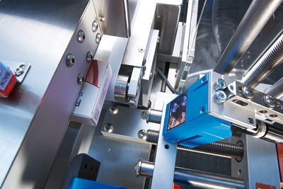

3.¶þάÌõÂëÔĶÁÆ÷Lector®620ÓÃÓÚÈÕ»¯ÐÐÒµ
¶þάÌõÂëÔĶÁÆ÷Lector620ÓÃÓÚÈÕÓðü×°ÐÐÒµ
