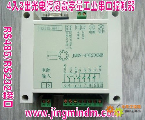

1¡¢JMDM-COM4DI2DOMRÊÇÉîÛÚÊо«ÃôÊý×Ö»úÆ÷ÓÐÏÞ¹«Ë¾×ÔÖ÷Ñз¢µÄÒ»¿î¹¤Òµ¼¶¸ßÐÔÄÜ΢Ð͵¥Æ¬»ú¿É±à³ÌÂß¼¿ØÖÆÆ÷£¬Ò²½Ð6µãÊý×ÖÁ¿£¨I/O£©´®¿Ú¿ØÖÆÆ÷¡£
2¡¢ÓÐ4·ȫ¹âµç¸ôÀëÊý×ÖÁ¿ÊäÈ룬2·¹âµç¸ôÀëºÍ¼ÌµçÆ÷¸ôÀëÁ½µÀ¸ôÀëÊä³ö£¬¿¹µç´Å¸ÉÈÅÄÜÁ¦¸üÇ¿£¬Ã¿Â·×î´ó¸ºÔØAC220V*10A¡¢DC24V*10A£¬RS485/RS232½Ó¿Ú¿ÉÑ¡¡£
3¡¢ÊäÈëµãÓÃ;£º
¿ÉÓÃÓڲɼ¯4·ÒÔϵĺìÍâ¸ÐÓ¦¿ª¹Ø¡¢¹âµç¸ÐÓ¦¿ª¹Ø¡¢½Ó½ü¿ª¹Ø¡¢»ô¶û´«¸ÐÆ÷µÈÊý×ÖÁ¿¿ª¹ØÁ¿Ðźš¢»òÖ±Á÷µç·µÄµçÏß·ÐźÅͨ¶Ï¼ì²â¡£

1¡¢¹¤×÷µçÔ´£ºDC24V 1A£¨»òAC18V 1A£©£¬Ò²¿É¶¨ÖÆÎªDC12V 1A£¨»òAC12V 1A£©£»¿ØÖÆÆ÷×Ô´øÕûÁ÷µç·£¬ÊäÈë²»·ÖÕý¸º£¬Òò´Ë½»Á÷Ö±Á÷µçԴͨÓá£
2¡¢8λ¸ßÐÔÄܵ¥Æ¬»ú¿ØÖÆ£»
3¡¢2ÖÖͨÐŽӿڿÉÑ¡£ºÓÐÁ½¸ö¶Ì·ñ£¬¿ÉÒÔͨ¹ýÉèÖÃÕâÁ½¸ö¶Ì·ñÀ´Ñ¡ÔñRS232»òRS485ͨÐÅ£»
4¡¢¿ØÖÆÆ÷¹¤×÷״ָ̬ʾ£ºÁ½¸öLEDµÆ·Ö±ðÏÔʾµçÔ´ºÍÔËÐÐ״̬£»
5¡¢2·¼ÌµçÆ÷Êä³ö£º¹âµç¸ôÀëºÍ¼ÌµçÆ÷¸ôÀëÁ½µÀ¸ôÀëÊä³ö£¬¿¹¸ÉÈÅÄÜÁ¦¸üÇ¿£¬ÎÞÔ´¸É´¥µãÐÎʽ£¬¿ÉÖ±½Ó¿ØÖƽ»Á÷×î´ó220Vµçѹ£¬Ö±Á÷×î´ó24Vµçѹ£»Ã¿Â·×î´óÊä³öµçÁ÷10A£¬Êä³ö¿Ú״̬¿É»Ø¶Á£»
6¡¢4·¹âµç¸ôÀëÊý×ÖÁ¿ÊäÈ룬Êý×ÖÁ¿ÊäÈëµÄÊäÈëµçѹ·¶Î§Îª3.3V¡ª24V£»ÊäÈëµçÁ÷Ϊ5-10MA£»¿ÉÓÃÓÚ¼ì²âÍⲿ¸÷ÖÖÐźŵĴ«¸ÐÆ÷ÊäÈ룬Èç¹âµç´«¸ÐÆ÷¡¢ºìÍâ´«¸ÐÆ÷¡¢»ô¶û´«¸ÐÆ÷¡¢½Ó½ü¿ª¹Ø¡¢µã¶¯¿ª¹ØµÈÊý×ÖÁ¿ÊäÈëÆ÷¼þµÈ
7¡¢2ÖÖͨÐŽӿڿÉÑ¡£º1¸öRS485½Ó¿ÚºÍ1¸öRS232½Ó¿Ú¿ÉÑ¡£»1·±ê×¼µÄRS232´®ÐÐͨÐŽӿڣ¨¿¹15KV¾²µç³å»÷£©£¬¿ÉÒÔÓëµçÄÔµÈÉÏλ»úͨÐÅ£¬¹¹³É´óµÄͨÐÅϵͳ£»¿ÉÖ±½Óͨ¹ýRS232½Ó¿ÚÏÂÔØ³ÌÐò£¬ÎÞÐèÉÕ¼Æ÷£¬·½±ã³ÌÐòÐ޸ġ¢Éý¼¶£»
8¡¢ÏµÍ³Îȶ¨ÐÔ£º²ÉÓ÷ÀÀ×»÷ºÍ¾²µç±£»¤µçÔ´µç·Éè¼Æ£¬¼ÌµçÆ÷Êä³ö²ÉÓÃ¸ßÆµÂ˳ýµç·£¬²úÉú¼«Ð¡µÄг²¨£»Ê¹ÏµÍ³¾ßÓм«¸ßµÄÎȶ¨ÐԺͼ«³¤µÄ¹¤×÷ÊÙÃü£»
9¡¢3ÖÖ¹¤×÷·½Ê½£ºÖ§³Ö¶ÀÁ¢¿ØÖÆ(µ¥Æ¬»úÓÃCÓïÑÔKEIL C±àд³ÌÐò)¡¢RS232´®¿Ú¼à¿Ø¡¢RS485´®¿Ú¼à¿Ø3ÖÖ·½Ê½£»
10¡¢ÏµÍ³Îȶ¨ÐÔ£º¾ßÓй¤Òµ¼¶·ÀÀ×»÷¡¢¿¹Ç¿µç´Å¸ÉÈÅ¡¢¸ß¿É¿¿ÐÔÄÜ£¬ÎÞËÀ»úÏÖÏó¡£
11¡¢Êý×ÖÁ¿¹¤×÷״ָ̬ʾµÆ£ºÃ¿Â·Êý×ÖÁ¿ÊäÈëÊä³ö¶¼ÓÐÒ»¸öָʾµÆ£¬·½±ã¹Û²ìÊäÈëµã¹¤×÷״̬£»
12¡¢ÍâÐγߴ磺³¤¿í¸ß£ºÍâ¿Ç£º115mm¡Á90mm¡Á40mm£»PCB°å£º91mm¡Á85mm¡Á22mm£»
