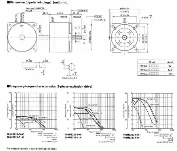

²úÆ·Ãû³Æ£º 103H8222-5142,103H8222-5041²½½øµç»ú
ÐÍ ºÅ£º 103H8222-5142
¾øÔµÇ¿¶È£º1000VAC
¾øÔµµç×裺100M¦¸£¨500VDC£©
¾øÔµÀàÐÍ£ºB type
¾¶Ïò¸ºÔØ£º220N
ÖáÏò¸ºÔØ£º60N
* ¸ºÔصãÔÚ´ÓÖáÄ©¶ËÆðµÄ1/3´¦
µçÆø¹æ¸ñ (µ¥¼«ÏßȦ)
ÐͺÅ
ÖáÊý
²½¾à½Ç
(¡ã)
µçѹ
(V)
ÏàµçÁ÷
(A/phase)
Ïàµç×è
(¦¸/phase)
Ïàµç¸Ð
(mH/phase)
±£³Öת¾Ø
N.m(kgf.cm)
ת×Ó¹ßÁ¿
(¡Á10-4kg.m2)
ÖØÁ¿
(Kg)
½ÓÏß·½Ê½
103H8221-5041(5011)
µ¥Öá
(Ë«Öá)
1.8
4.6
2
2.3
14
2.75(28)
1.45
1.5
¢ñ
103H8221-5141(5111)
2.4
4
0.6
3.5
103H8221-5241
1.8
6
0.3
1.65
103H8222-5041(5011)
5.4
2
2.7
23
4.9(50)
2.9
2.9
103H8222-5141(5111)
2.8
4
0.7
5.7
103H8222-5241
2.28
6
0.38
2.7
103H8223-5041(5011)
7.2
2
3.6
32.5
6.85(70)
4.4
4.4
103H8223-5141(5111)
3.6
4
0.9
8.1
103H8223-5241
2.7
6
0.45
3.4
µçÆø¹æ¸ñ (Ë«¼«ÏßȦ)
ÐͺÅ
ÖáÊý
²½¾à½Ç
(¡ã)
µçѹ
(V)
ÏàµçÁ÷
(A/phase)
Ïàµç×è
(¦¸/phase)
Ïàµç¸Ð
(mH/phase)
±£³Öת¾Ø
N.m(kgf.cm)
ת×Ó¹ßÁ¿
(¡Á10-4kg.m2)
ÖØÁ¿
(Kg)
½ÓÏß
·½Ê½
103H8221-0941
µ¥Öá
(Ë«Öá)
1.8
2.48
4
0.62
1.8
2.15
1.45
1.5
¢ò
103H8222-0941
3.88
4
0.97
3.6
4.13
2.9
2.5

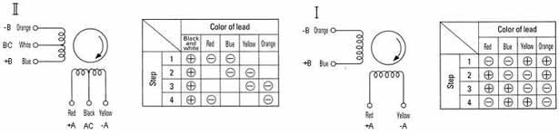

µç»úÄÚ²¿½ÓÏß¼°Ðýת·½Ïò (´Ó°²×°»ù×ù´¦¿´)
³ß´çͼ
