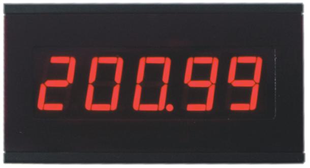

FY5135B FY5130B FY5140B FY5145B ÊýÏÔÃæ°å±í Êý×Öµçѹ±í Êý×ÖµçÁ÷±í
FY5130B ÈýλÊý×Ö±íÍ· FY5135B Èýλ°ëÊý×Ö±íÍ· FY5140B ËÄλÊý×Ö±íÍ· FY5145B ËÄλ°ëÊý×Ö±íÍ·

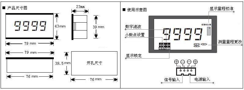

Îå¡¢²úÆ·³ß´ç¼°Ê¹ÓÃ˵Ã÷
