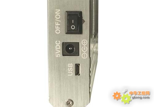

     ÓÒͼΪÒÇÆ÷µÄ²à±ß´ò±êÎÄ×Ö¡£
?    “OFF/ON” ΪÒÇÆ÷¿ª¹Ø
?    “5VDC” ΪAC/DCµçÔ´²å¿Ú
?    “USB” Ϊһ¸öMicro USB×ù£¬·½±ãÒÆ¶¯µçÔ´¸øÒÇÆ÷¹©µç

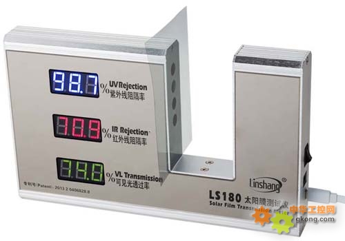

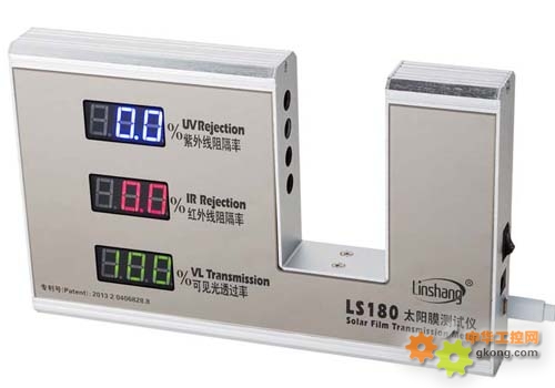

1£º²åÉϵçÔ´£¬±£³Ö²âÊÔ²ÛÄÚΪ¿Õ£¬´ò¿ª²âÊÔÒǵĵçÔ´¿ª¹Ø£¬Ê×ÏÈÏÔʾÒÇÆ÷°æ±¾ºÅ¼°ÒÇÆ÷Ðͺźó£¬×ÏÍâÏß×è¸ôÂʺͺìÍâÏß×è¸ôÂÊ´°¿ÚÊý¾ÝÏÔʾΪ“0.0”£¬ ¿É¼û¹â͸¹ýÂÊ´°¿ÚÏÔʾΪ100¡£±íʾÎÞ±»²âÎïʱ£¬ºìÍâÏߺÍ×ÏÍâÏßµÄ×è¸ôÂÊΪ0% £¬¿É¼û¹â͸¹ýÂÊΪ100%¡£
2£º½«±»²âÊÔÎ̫ÑôĤ£¬ÌùĤµÄ²£Á§µÈ£©·ÅÈë²âÊÔ²ÛÄÚ¡£Èý¸öÏÔʾÆ÷·Ö±ðÏÔʾ±»²âÎï¶Ô×ÏÍâÏß×è¸ôÂÊ£¬ºìÍâÏß×è¸ôÂʺͿɼû¹âµÄ͸¹ýÂÊ¡£
 ÈçÏÂͼËùʾ£ºÑùÆ·Ì«ÑôĤµÄ×ÏÍâÏß×è¸ôÂÊΪ98.7%£¬ºìÍâÏß×è¸ôÂÊΪ70.9%£¬¿É¼û¹â͸¹ýÂÊΪ74.0%¡£
