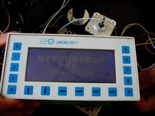

JMDM-2011¾«ÃôÖÆ´ü»ú·âÇлúÇиî»ú¿ØÖÆÆ÷
---JMDM-2011¶à¹¦Äܹ¤Òµ¿ØÖÆÆ÷ÔÚÖÆ´ü»ú·âÇлúÇиî»úÉϵĵäÐÍÓ¦ÓÃ
Ò»¡¢²úÆ·¼ò½é
JMDM£¨¾«Ãô£©·âÇлú¿ØÖÆÏµÍ³£¬ÓÖÃûÇиî»ú¡¢ÖÆ´ü»ú¿ØÖÆÏµÍ³£¬²ÉÓÃJMDM-2011¼¯³É¶à¹¦ÄÜÐ͹¤Òµ¿ØÖÆÆ÷£¬¾ßÓиßÇåÒº¾§LCDÀ¶ÆÁÏÔʾ¡¢·½±ãµÄÈË»ú½»»¥½çÃæ¡¢¸ß¾«¶È¸ßËÙ¶È¡¢¿¹Ç¿¸ÉÈÅÄÜÁ¦¡¢¹¦ÄÜÇ¿´ó¡¢Îȶ¨¿É¿¿µÈÌØµã,¿É¿ØÖÆ20·I/OÊý×ÖÁ¿Ðźţ¬¼°1·²½½ø/ËÅ·þµç»ú¸ßËٸ߾«¶ÈÔ˶¯£¬Êä³ö¸ßËÙÂö³åƵÂÊ×î¸ß´ï400KHZ£¬¶¨Î»¶¨³¤¿ØÖƾ«¶È¸ß´ï0.01mm£¬ÓÅÒìÐÔÄܱíÏÖÔ¶Ô¶¸ßÓÚ¹úÄÚÍâPLC¡£
