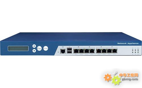

Intel® Xeon™/Core™ 2 Duo 1U上架式机箱,带8个PCIe千兆网口
产品亮点
整机:NSA5110
机箱:DTX-105D
主板:NSB5110
CPU:INTEL至强3210
内存:8G DDR3
硬盘:500G SATA
电源:300W电源(可选配4个千兆网口)
8个intel 82574L千兆网口(支持BY PASS功能),1个VGA口,1个CONSOLE口,2个USB口,1个板载CF卡卡槽,1个PCI-E插槽。可扩展网口模块,具体可扩展规格:2个电口2个光口、4个电口、4个光口、4个电口4个光口、8个电口、8个光口。
特点详情
1U机架式网络安全平台,整机尺寸426mmx 457mm x 44mm,主板采用INTEL 3210芯片组,CPU可采用INTEL至强3210处理器,整机提供1个PCI-E扩展插槽。机器支持BYPASS功能,网络唤醒功能。机箱支持前端LCD模块
Specifications
主板
  • NSB5110
  • Supports Intel® Xeon™/ Core™ 2 Duo /Pentium®Dual-Core/ Celeron® Processors, LGA775 socket, max 65w
  • Support 800/1066/1333 MHz FSB
  • Intel® 3210 and ICH9R Chipset
内存
  • 4 x 240-pin DDR II 667/800 DIMM Sockets, up to 8GB ECC or Non-ECC DDR II SDRAM
网络特点
  • LAN Chip: Intel® 82574L and 82575EB
  • Support 10/100/1000 link speed
  • LAN Bypass: 4 pairs
扩展
  • 1 x PCIe x 8 Slot
I/O接口-前面板
  • Support 2 x16 Characters LCD module, PIO interface
  • Power status / HDD status / LAN status / Bypass status LEDs
  • 2 x USB 2.0 ports
  • 1 x RJ45 type Console port
  • 1 x software button
  • 8 x Copper LAN ports
I/O接口-后面板
  • 1 x Expansion slot
  • 1 x USB 2.0 port
  • 1 x VGA port
设置
  • 1 x on-board CompactFlash socket
  • 1 x Internal 3.5" HDD drive bay
  • 1 x SATA-DOM device space
电源输入
  • 250W ATX Power Supply
认证
  • CE approval
  • FCC Class A
  • UL
机箱体积
  • Chassis Dimension: 426mm x 457mm x 44mm
  • Carton Dimension: 560mm x 620mm x 190mm
重量
  • Without Packing: 8kg
  • With Packing: 12kg
订购信息
  • NSA 5110 (P/N: 10S00511000X0)Support Intel® Xeon™/Core™ 2 Duo/Pentium® Dual-Core/Celeron®, 4 DDR2 memory slots, 8 Gigabit LAN ports, CompactFlash Socket, VGA, USB port, One PCIe x8 Expansion Slot
  • NSA 5110-C6F2 (P/N: 10S00511002X0)Support Intel® Xeon™/Core™ 2 Duo/Pentium® Dual-Core/Celeron®, 4 DDR2 memory slots, 6 Copper Ports and 2 Fiber Ports, CompactFlash Socket, VGA, USB port, One PCIe x8 Expansion Slot
