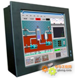

Low Power and Touch Screen Ready 17” Panel PC
产品亮点
· Intel Celeron-M ULV 1.0GHz Onboard
· Small Size, Low power consumption and economical solution
· Compact size with high performance
· High Speed Gigabit LAN Controller
· High precision touch screen
· Onboard IDE interface, Type II CF Slot
· 24V DC Power Support
特点详情
>> Systems
CPU Type                            Intel Celeron-M ULV 1.0GHz Onboard
Chipset                               Intel 855GME+ICH4
DRAM                                  1 x 200-pin SO-DIMM, Support DDR333 max up to 1GB
Front Bezel                          Aluminum
IP65/NEMA4                         Yes
Power Supply                       DC 24V 60W Power Supply / AC 100~240V (optional power adaptor)
Dimension                             450×350×107
Weight                                11.5Kg
Certificate                           CE/FCC
>> I/O Ports
IDE Interface                       1 × 2.5” HDD, 1 × IDE CF Slot Onboard
Audio                                  ALC202A AC’97 Codec, Interface: Line In / Line Out / MIC in
Serial Port                           4 × COMs, Interface: COM1 for RS232, COM2 for RS232/422/485, with D-Sub
                                          COM3 COM4 for RS232 onboard
Parallel                                1 × Parallel Port (SPP/EPP/ECP)
KB/Mouse                           2 × Switchable for Keyboard and Mouse
LAN                                     1 × Gigabit LAN (10M/100M/1000M)
USB                                    2 × USB 2.0 ports on rear panel, 2 × USB2.0 ports onboard
Brightness Control                VR on rear Panel
>> Display
LCD                                    17” SXGA TFT LCD
Typical White                       300cd/㎡
Contrast Ratio                      500:1
Viewing Angle                      70/70/70/60 (L/R/U/D)
Touch Screen                       5W Analog resistive (USB interface)
>> Environment
Temperature                        0°~40°C
Storage temperature            -20°~65°C
Humidity                              Operation Humidity 20~90%, Storage Humidity 20~95%
订购信息
Order Number
Description
UFP6317
Panel PC with 17”LCD, Intel Celeron-M ULV 1.0GHz CPU onboard, resistive Touch Screen, 60W DC Power supply
