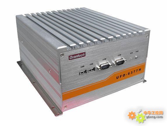

²úÆ·Ãû³Æ£º °¬Ñ¶ºê´ïÎÞ·çÉÈÕû»ú_UFO6377H-525-NM
ÐÍ ºÅ£º UFO6377H-525-NM
Æ· ÅÆ£º 1243
Intel Atom D525ǶÈëʽÎÞ·çÉȹ¤ÒµµçÄÔ£¬´øË«PCI²å²Û
²úÆ·ÁÁµã
  • Intel Atom D525 @1.8GHz Dual Core Pineview-D ´¦ÀíÆ÷
  • Intel® D525 + ICH NM10
  • VGA / 2¸öǧÕ×Íø¿Ú/ 4USB / ÒôƵ/ 5COM¿Ú
  • ´ø2¸öPCI²å²Û
  • +12V DC ATXµçÔ´ÊäÈë
  • Ö§³ÖDDRIII 240Õë 800/1066 MHzÄÚ´æ
  • Ö§³Ö2.5¡åSATA2Ó²ÅÌMini PciE½Ó¿Ú
ÌØµãÏêÇé
´¦ÀíÆ÷                      Intel Atom D525 @1.8GHz Dual Core Pineview-D ´¦ÀíÆ÷£¨°åÔØ£©
оƬ×é                      Intel® D525 + ICH NM10
ÄÚ´æ                         Ö§³ÖDDRIII 240Õë 800/1066MHzÄÚ´æ, ×î¸ß¿É´ï8G £¨¿ÉÑ¡£©
Ó²ÅÌ                     Ö§³Ö2.5¡åSATA2Ó²ÅÌ £¨¿ÉÑ¡£©
ÏÔ¿¨                         Intel Pineview-D ¼¯³ÉͼÐÎÒýÇæ, ×î´ó¹²Ïí384MBÄÚ´æ

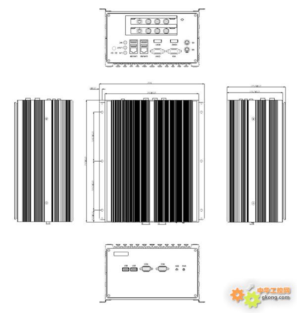

¹æ¸ñ                        W:200mm D:260mm H:120.2mm
²ÄÖÊ                         ÂÁ + SECC1.2 (ºÚÉ«£¬ÒøÉ«¿ÉÑ¡)
