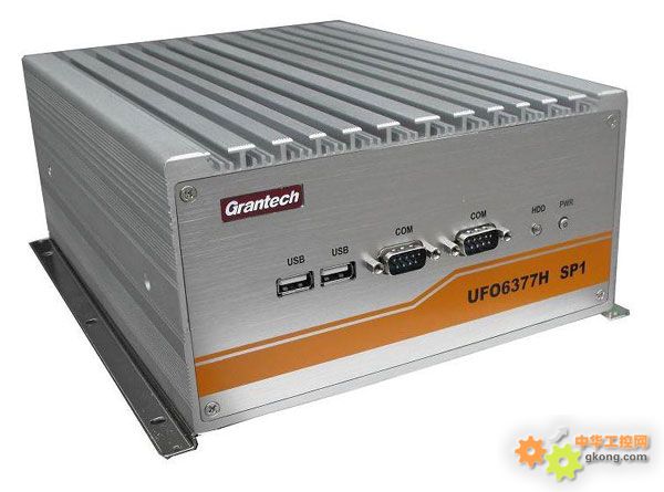

Intel Atom D525ǶÈëʽÎÞ·çÉȹ¤¿Ø»ú£¬´øPCIÀ©Õ¹²Û
²úÆ·ÐÅÏ¢
  • Intel Atom D525 @1.8GHz Dual Core Pineview-D ´¦ÀíÆ÷
  • Intel® D525 + ICH NM10
  • VGA / 2ǧÕ×Íø¿Ú / 4USB½Ó¿Ú / ÒôƵ/ 5COM
  • Ö§³Ö1¸öPCIÀ©Õ¹²Û
  • +12V DC ATXµçÔ´ÊäÈë
  • Ö§³ÖDDRIII 240Õë 800/1066 MHzÄÚ´æ
  •  Ö§³Ö2.5¡åSATA2Ó²Å̺ÍMini PciE½Ó¿Ú

´¦ÀíÆ÷               Intel Atom D525 @1.8GHz Dual Core Pineview-D´¦ÀíÆ÷£¨°åÔØ£©
оƬ×é               Intel® D525 + ICH NM10
ÄÚ´æ                  Ö§³ÖDDRIII 240Õë 800/1066MHzÄÚ´æ, ×î¸ß¿É´ï4G £¨¿ÉÑ¡£©
Ó²ÅÌ                  Ö§³Ö2.5¡åSATA2Ó²ÅÌ£¨¿ÉÑ¡£©
ÏÔ¿¨                  Intel Pineview-D¼¯³ÉͼÐÎÒýÇæ, ×î´ó¹²Ïí384MBÏÔ´æ
Ç°Ãæ°å
                         1µçÔ´¿ª¹ØºÍµçԴָʾµÆ
                     1
Ó²ÅÌ״ָ̬ʾµÆ
                     2¸öCOM-232¶Ë¿Ú
                     2
¸öUSB¶Ë¿Ú
I/O ¶Ë¿Ú
                     1DC12VÊäÈë
                     1VGA¿Ú
                     2
¸öǧÕ×Íø¿Ú(Realtek RTL 8111E)
                     4USB 3COM (1*232/422/485 2*232)
                     1PS/2
½Ó¿Ú
                     1
×éLine-In/Line-Out/MIC-In
Ö§³ÖÒ»¸öPCIÀ©Õ¹²Û

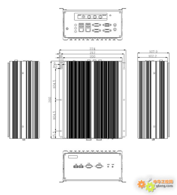

¹æ¸ñ                 W:200mm D:260mm H:102mm
²ÄÖÊ                   ÂÁ + SECC1.2 (Black)
µçÔ´
                          Ö±Á÷µçÔ´ÊÊÅäÆ÷(90W)
ÊäÈë : AC100~240V 1.5A 50~60MHz
Êä³ö : DC 12V 7.5A(MAX)
ÖØÁ¿                    4.9KG
ÔËÐл·¾³
                      ÔËÐÐÎÂ¶È 0~50 ¡ãC
Ïà¶Ôʪ¶È 10~95% @40¡ãC,ÎÞÀäÄý
