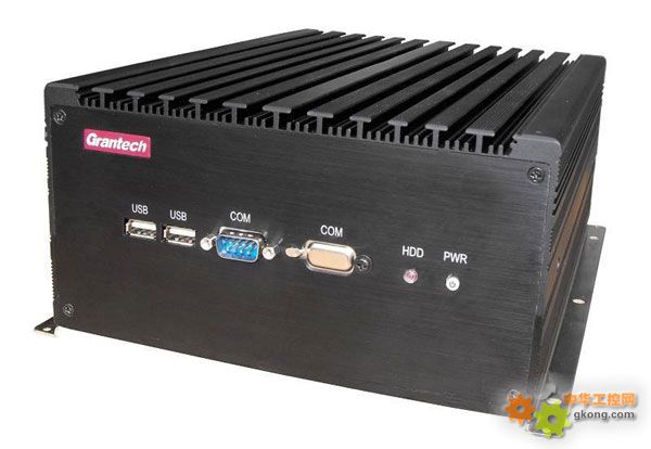

Intel Core™2 ǶÈëʽÎÞ·çÉȹ¤¿Ø»ú£¬´øPCI²å²Û
²úÆ·ÁÁµã
  • Intel Core 2 Duo Mobile Penryn/Core 2
  • Extreme /Celeron M (575/585) CPU
  • Intel GM45 + ICH9M
  • VGA /2*HDMI / 2¸öǧÕ×Íø¿Ú/ 6*USB / ÒôƵ/ 2*COM
  • Ö§³ÖÒ»¸öPCIÀ©Õ¹²Û
  • 12V DCÊäÈëATXµçÔ´
  • Ö§³ÖDDR2 800/667MHzÄÚ´æ, ×î´óÄÚ´æ¿É´ï4GB
  • Ö§³Ö2.5¡åSATA2Ó²Å̺Í44ÕëIDE½Ó¿Ú
ÌØµãÏêÇé
´¦ÀíÆ÷                         Intel Core 2 Duo Mobile Penryn/Core 2 Extreme /Celeron M (575/585) CPU£¨¿ÉÑ¡£©
оƬ×é                           Intel GM45 + ICH9M
ÄÚ´æ                              Ö§³ÖDDR2 800/667MHzÄÚ´æ, ×î¸ß¿É´ï4GB  (¿ÉÑ¡)
´æ´¢                              Ö§³Ö2.5¡åSATA2 Ó²Å̺Í44ÕëIDE½Ó¿Ú (¿ÉÑ¡)
ͼÐΠ                              Intel Gen 5.0¼¯³ÉͼÐÎÒýÇæ, ×î´óϵͳ¹²ÏíÄÚ´æ1GB
Ç°Ãæ°å
                                     1¸öµçÔ´¿ª¹ØºÍµçԴָʾµÆ
                                     1¸öÓ²ÅÌָʾµÆ
                                     1¸öCOM¶Ë¿Ú
                                     2¸öUSB½Ó¿Ú
I/O¶Ë¿Ú
                                     1¸öDC12VµçÔ´ÊäÈë
                                     1¸öVGA¿Ú¡¢2¸öHDMI¿Ú
                                     2¸öǧÕ×Íø¿Ú(Intel 82574L)
                                     4¸öUSB¿Ú  1¸öCOM¿Ú
                                     1¸öPS/2½Ó¿Ú
                                     1¸öLine-In/Line-Out/MIC-In
À©Õ¹                               Ö§³Ö1¸öPCI²å²Û

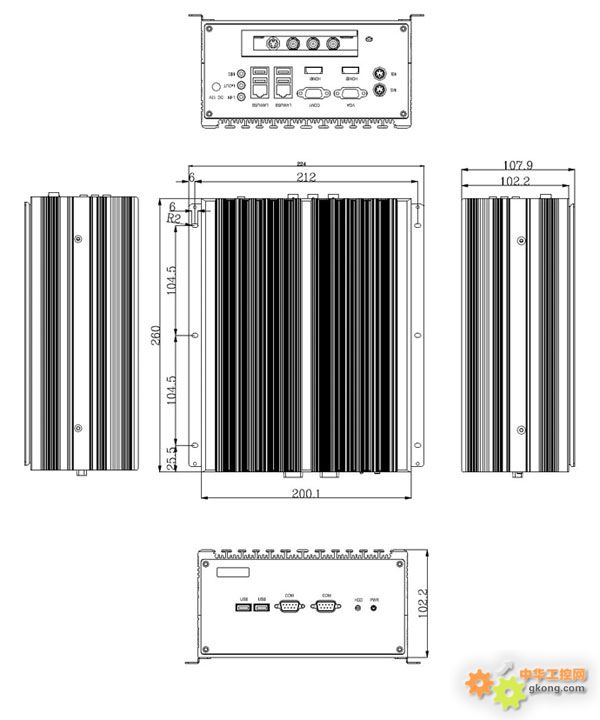

¹æ¸ñ                               W:200mm D:260mm H:102mm
