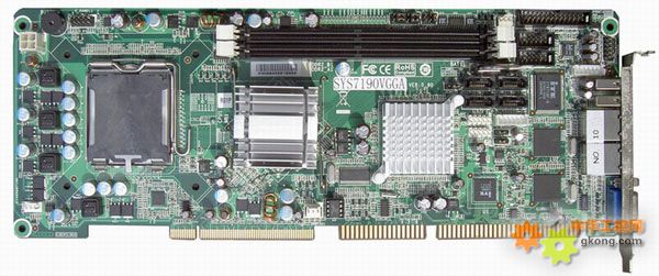

²úÆ·Ãû³Æ£º °¬Ñ¶ºê´ïÈ«³¤CPU¿¨¡ª¡ªSYS7190VGA
ÐÍ ºÅ£º SYS7190VGA
Æ· ÅÆ£º 1243
PICMG1.0 Intel Q35 CPU³¤¿¨£¬´øVGA/1¸öǧÕ×Íø¿Ú/Éù¿¨
²úÆ·ÁÁµã
  • LGA775, Intel Core 2 Extreme / Core 2 Quad / Core 2 Duo /Pentium Dual-Core /  Pentium EE / Pentium D /Pentium 4 / Celeron 400 with 45nm
  • Intel Q35 + ICH9DO + ǰ¶Ë×ÜÏß800/1066/1333MHz
  • ˫ͨµÀDDRII 667/800/1066Äڴ棬¸ß´ï4GB
  • 1 x Intel PCI-EǧÕ×Íø¿Ú
  • 2¸ö´®Ðж˿Ú, 6¸öUSB2.0¿Ú
ÌØµãÏêÇé
>>ϵͳ²ÎÊý
 CPU                   LGA775, Intel Core 2 Extreme / Core 2 Quad / Core 2 Duo /Pentium Dual-Core / Pentium EE /Pentium D / Pentium 4 / Celeron 400 with 45nm
оƬ×é                  Intel Q35 + ICH9DO + Ç°¶Ë×ÜÏß800/1066/1333MHz
DRAM                   2 x 240
Õ룬˫ͨµÀDDRII667/800/1066Äڴ棬×î¸ß¿É´ï4GB
BIOS                    Award BIOS
×ÜÏß                     PICMG 1.0
µçÔ´                     Ö§³ÖACPI V2.0 specification
¿´ÃŹ·                   1~255Ãë¿ÉÑ¡¿´ÃŹ·¶¨Ê±Æ÷ w/Reaset/NMI
¹æ¸ñ                      338.58mm x 122mm
>>I/O¶Ë¿Ú
HDD                                  4 x SATA-II½Ó¿ÚÖ§³ÖRAID 0/1/5/10
´®¿Ú                                  2¸ö´®Ðж˿Ú, COM1Ö§³ÖRS232, COM2Ö§³ÖRS232/422/485
²¢¿Ú                                  1¸ö²¢¿Ú
ÒôƵ                                 IntelHDÒôƵ±à½âÂëÆ÷(¿ÉÑ¡)
¼üÅÌ/Êó±ê                            1¸ö΢ÐÍDIN½Ó¿ÚµÄPS / 2¼üÅ̺ÍÊó±ê
Íø¿Ú                                   1 x Intel PCI-EǧÕ×Íø¿Ú
USB                                   6 x USB2.0
>>ÏÔʾ
ͼÐΠ                             Intel ͼÐÎýÌå¼ÓËÙÆ÷X3100
>>»·¾³
ÔËÐÐζȠ                        0¡ã~60¡ãC (32¡ã~140¡ãF)
Ïà¶Ôʪ¶È                            10~90%
¶©¹ºÐÅÏ¢
Model                              Description
SYS7190VGA                    PICMG1.0 Intel Q35 Full Size CPU Card w VGA/Giga LAN/Audio
SYS7190VGGA                  PICMG1.0 Intel Q35 Full Size CPU Card w VGA/2*Giga LAN/Audio
