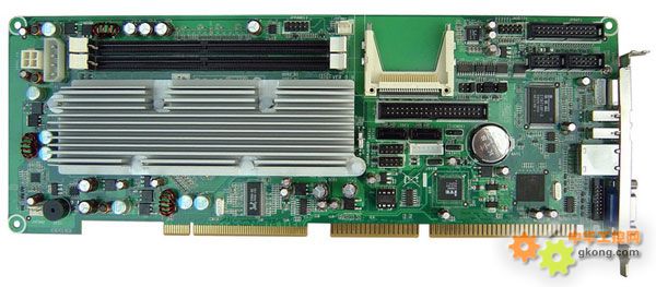

²úÆ·Ãû³Æ£º °¬Ñ¶ºê´ïCPU³¤¿¨¡ª¡ªSYS71688VGA
ÐÍ ºÅ£º SYS71688VGA
Æ· ÅÆ£º 1243
Intel Atom 230 PICMG1.0 CPU¿¨£¬´øVGA/ǧÕ×Íø¿Ú/ÒôƵ
²úÆ·ÁÁµã
  • °åÔØÓ¢ÌØ¶ûÁ趯230´¦ÀíÆ÷£¨1.6G/4W£©£¬FSB 533MHz
  • ²ÉÓÃIntel 945GC+ICH7оƬ×é
  • ˫ͨµÀÄÚ´æ½Ó¿Ú£¬×î¶àÖ§³Ö4GBµÄDDR2 533/677MHzÄÚ´æ
  • Ó¢ÌØ¶ûGMA 950ͼÐÎýÌå¼ÓËÙÆ÷£¬×î´ó¹²ÏíÄÚ´æ224M
  • 1¸öIntel 82573L PCI-EǧÕ×ÍøÂç¿ØÖÆÆ÷
  • 2¸öSATAIIÓ²Å̽ӿÚ
  • 1¸öRS-232£¬1¸öRS-232/422/485½Ó¿Ú
  • 6¸öUSB2.0½Ó¿Ú
  • PICMG1.0×ÜÏߣ¬Ö§³ÖPCI¼°ISAÀ©Õ¹É豸
ÌØµãÏêÇé
CPUÀàÐÍ
°åÔØIntel×îС¹¦ºÄ×îµÍµÄAtom 230´¦ÀíÆ÷
CPUƵÂÊ
1.6GHz
оƬ×é
Intel 945GC + ICH7, FSB 400MHz
ÄÚ´æ
2 x 240Õë DDRII DIMMÄڴ棬×î¸ß¿ÉÖ§³Ö4GB DDRII 533/667
BIOS
Award 8Mbit PnP with VGA BIOS
ÏÔʾ
InetelͼÐζàýÌå¼ÓËÙÆ÷(GMA) 950£¬ ×î´ó¹²Ïí224MÄÚ´æ
Íø¿Ú
LAN1£ºIntel 82573L ͨ¹ýPCI-EÖ§³ÖǧÕ×Íø¿Ú
USB
6 x USB2.0
Ó²Å̽ӿÚ
1 x IDE, 2 x SATA II
´®¿Ú
2 x COM½Ó¿Ú,COM1Ö§³ÖRS232,COM2Ö§³ÖRS232/422/485
²¢¿Ú
Ö§³Ö1 x ECP/EPP/SPP
¼üÅÌ/Êó±ê
1 x 6ÕëMini-DIN½Ó¿ÚÊó±ê¼üÅÌ
¿´ÃŹ·
ϵͳ¸´Î»»ò·ÇÆÁ±ÎÖжÏÈí¼þ¿É±à³ÌµÄʱ¼äÄÚ£¬ÌøÏßÑ¡Ôñ255¼¶
Realtek ALC 662   Line-in / Line-out / MIC3ÒôƵ¿Ú
À©Õ¹²¿¼þ
ITE IT8888G PCI/ISAÇÅ£¬Ö§³ÖISAÀ©Õ¹
ISA¸ßÇý¶¯Æ÷Ö§³Ö
µçÔ´
ATXµçÔ´
ÔËÐÐζÈ
0¡æ~60¡æ
Ïà¶Ôʪ¶È
-40¡æ~ 85¡æ
¹æ¸ñ(LxW)
338mmx 122mm(13.3¡± x 4.8¡±)
¶©¹ºÐÅÏ¢
Model                    SYS71688VGA
Description           Onboard Intel Atom 230 PICMG1.0 CPU Card w VGA/Audio/Giga LAN
