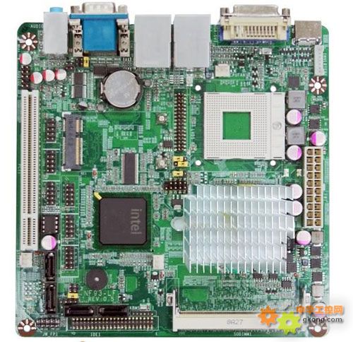

²úÆ·Ãû³Æ£º °¬Ñ¶ºê´ïMini-ITXÖ÷°å(170*170)¡ª¡ªSYS76952VGGA-R
ÐÍ ºÅ£º SYS76952VGGA-R
Æ· ÅÆ£º 1243
Intel GM45 Mini-ITXÖ÷°å£¬w VGA/2¸öǧÕ×Íø¿Ú/ÒôƵ/TV-OUT/RAID
²úÆ·ÁÁµã
  • Socket P,Ö§³ÖCore 2 Extreme/Core 2 Duo/Celeron M´¦ÀíÆ÷
  • Intel GM45+ICH9M
  • 2 x SO-DIMM, DDR2 800/667Äڴ棬¸ß´ï4GB
  • Ö§³ÖVGA/DVI-D/LVDS/HDMI/TV-OUT,Ö§³ÖË«ÏÔ
  • 2 x Realtek RTL8111CǧÕ×Íø¿Ú
  • 3 x RS232, 1 x RS232/422/485, 10 x USB2.0
  • 1 x PCI, 1 x Mini-PCIeÀ©Õ¹²Û
ÌØµãÏêÇé
>> ϵͳ²ÎÊý
CPU                                 Socket P, Ö§³ÖPenryn Intel Core 2 Extreme / Core 2 Duo / Celeron M´¦ÀíÆ÷
оƬ×é                              Intel GM45 + ICH9M, 667/800/1066MHz FSB
DRAM                               2 x 200Õë SO-DIMM DDR2 800/667Äڴ棬×î¸ß¿É´ï4GB
BIOS                                Award 8M Flash BIOS
µçÔ´                                Ö§³ÖACPI 2.0 specification, ATX 24Õë + ATX 4Õë
¿´ÃŹ·                              ¿´ÃŹ·¶¨Ê±Æ÷¹¦ÄÜ
¹æ¸ñ                                 170mm x 170mm
>> I/O ¶Ë¿Ú
Ó²ÅÌ                                 1 x 44Õë IDE, 4 x SATAII½Ó¿Ú, Ö§³ÖRADI0/1/5/10
´®¿Ú                              3 x RS232, 1 x RS232/422/485 COM¶Ë¿Ú
ÒôƵ                              Realtek ALC888 HDÒôƵ½âÂëÆ÷, Mic-in / Line-in / Line-out
Íø¿Ú                                  2 x Realtek RTL8111C PCI-EǧÕ×ÒÔÌ«Íø½Ó¿Ú
USB                                  10 x USB2.0 (4¸ö½Ó¿Ú+ 6x Õë½ÓÍ·)
Êý×ÖIO                          1 x DIO½Ó¿Ú, 4½ø & 4³ö
À©Õ¹²Û                           1 x PCI, 1 x Mini-PCIeÀ©Õ¹²Û
>> ÏÔʾ
ͼÐΠ                          ¼¯³ÉIntel Gen5.0 graphics engine, ×î¸ß¿É´ï384MÊÓÆµÄÚ´æ
CRT                                   Ö§³ÖUXGA (1600x1200 @60Hz)
DVI                                   1 x DVI-I (½öµ¥DVI-D)
HDMI                                 1 x HDMI
LVDS                                 1 x 24λ˫ͨµÀLVDS½Ó¿Ú
TV-OUT                              1 x TV-OUT½ÓÍ·
>> »·¾³
ÔËÐÐζȠ                             0¡ã~60¡ãC (32¡ã~140¡ãF)
Ïà¶Ôʪ¶È                            10~90%
