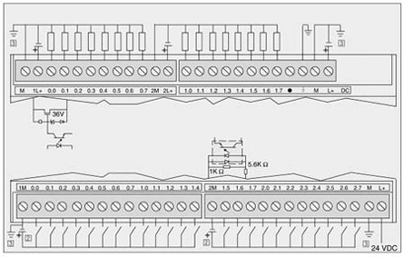

CPU 226 CN DC/DC/DC ¶Ë×ÓÁ¬½Óͼ

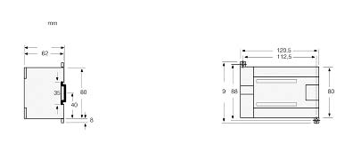

CPU 226 CN ³ß´çͼ
