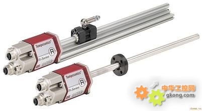

MTS´ÅÖÂÉìËõÎ»ÒÆ£¨ÒºÎ»£©´«¸ÐÆ÷£¬Í¨¹ýÄÚ²¿·Ç½Ó´¥Ê½µÄ²â¿Ø¼¼Êõ¾«È·µØ¼ì²â»î¶¯´Å»·µÄ¾ø¶ÔλÖÃÀ´²âÁ¿±»¼ì²â²úÆ·µÄʵ¼ÊÎ»ÒÆÖµµÄ£»¸Ã´«¸ÐÆ÷µÄ¸ß¾«¶ÈºÍ¸ß¿É¿¿ÐÔÒѱ»¹ã·ºÓ¦ÓÃÓÚ³ÉǧÉÏÍòµÄʵ¼Ê°¸ÀýÖС£
ÓÉÓÚ×÷Ϊȷ¶¨Î»ÖõĻ´Å»·ºÍÃô¸ÐÔª¼þ²¢ÎÞÖ±½Ó½Ó´¥£¬Òò´Ë´«¸ÐÆ÷¿ÉÓ¦ÓÃÔÚ¼«¶ñÁӵĹ¤Òµ»·¾³ÖУ¬²»Ò×ÊÜÓÍ×Õ¡¢ÈÜÒº¡¢³¾°£»òÆäËüÎÛȾµÄÓ°Ïì¡£´ËÍ⣬´«¸ÐÆ÷²ÉÓÃÁ˸߿Ƽ¼²ÄÁϺÍÏȽøµÄµç×Ó´¦Àí¼¼Êõ£¬Òò¶øËüÄÜÓ¦ÓÃÔÚ¸ßΡ¢¸ßѹºÍ¸ßÕñµ´µÄ»·¾³ÖС£´«¸ÐÆ÷Êä³öÐźÅΪ¾ø¶ÔÎ»ÒÆÖµ£¬¼´Ê¹µçÔ´Öжϡ¢Öؽӣ¬Êý¾ÝÒ²²»»á¶ªÊ§£¬¸üÎÞÐëÖØÐ¹éÁã¡£ÓÉÓÚÃô¸ÐÔª¼þÊǷǽӴ¥µÄ£¬¾ÍËã²»¶ÏÖØ¸´¼ì²â£¬Ò²²»»á¶Ô´«¸ÐÆ÷Ôì³ÉÈκÎÄ¥Ë𣬿ÉÒÔ´ó´óµØÌá¸ß¼ì²âµÄ¿É¿¿ÐÔºÍʹÓÃÊÙÃü¡£
MTS´ÅÖÂÉìËõÎ»ÒÆ´«¸ÐÆ÷¹¤×÷Ô­Àí£º
´ÅÖÂÉìËõÎ»ÒÆ£¨ÒºÎ»£©´«¸ÐÆ÷£¬ÊÇÀûÓôÅÖÂÉìËõÔ­Àí¡¢Í¨¹ýÁ½¸ö²»Í¬´Å³¡Ïཻ²úÉúÒ»¸öÓ¦±äÂö³åÐźÅÀ´×¼È·µØ²âÁ¿Î»Öõġ£²âÁ¿Ôª¼þÊÇÒ»¸ù²¨µ¼¹Ü£¬²¨µ¼¹ÜÄÚµÄÃô¸ÐÔª¼þÓÉÌØÊâµÄ´ÅÖÂÉìËõ²ÄÁÏÖÆ³ÉµÄ¡£²âÁ¿¹ý³ÌÊÇÓÉ´«¸ÐÆ÷µÄµç×ÓÊÒÄÚ²úÉúµçÁ÷Âö³å£¬¸ÃµçÁ÷Âö³åÔÚ²¨µ¼¹ÜÄÚ´«Ê䣬´Ó¶øÔÚ²¨µ¼¹ÜÍâ²úÉúÒ»¸öÔ²Öܴų¡£¬µ±¸Ã´Å³¡ºÍÌ×ÔÚ²¨µ¼¹ÜÉÏ×÷ΪλÖñ仯µÄ»î¶¯´Å»·²úÉúµÄ´Å³¡Ïཻʱ£¬ÓÉÓÚ´ÅÖÂÉìËõµÄ×÷Ó㬲¨µ¼¹ÜÄÚ»á²úÉúÒ»¸öÓ¦±ä»úе²¨Âö³åÐźţ¬Õâ¸öÓ¦±ä»úе²¨Âö³åÐźÅÒԹ̶¨µÄÉùÒôËÙ¶È´«Ê䣬²¢ºÜ¿ì±»µç×ÓÊÒËù¼ì²âµ½¡£
ÓÉÓÚÕâ¸öÓ¦±ä»úе²¨Âö³åÐźÅÔÚ²¨µ¼¹ÜÄڵĴ«Êäʱ¼äºÍ»î¶¯´Å»·Óëµç×ÓÊÒÖ®¼äµÄ¾àÀë³ÉÕý±È£¬Í¨¹ý²âÁ¿Ê±¼ä£¬¾Í¿ÉÒԸ߶Ⱦ«È·µØÈ·¶¨Õâ¸ö¾àÀë¡£ÓÉÓÚÊä³öÐźÅÊÇÒ»¸öÕæÕýµÄ¾ø¶ÔÖµ,¶ø²»ÊDZÈÀýµÄ»ò·Å´ó´¦ÀíµÄÐźÅ,ËùÒÔ²»´æÔÚÐÅºÅÆ¯ÒÆ»ò±äÖµµÄÇé¿ö,¸üÎÞÐ趨ÆÚÖØ±ê¡£
MTS´ÅÖÂÉìËõÎ»ÒÆ´«¸ÐÆ÷½á¹¹²ÄÖÊ£º
²â¸Ë½á¹¹:¸ÕÐÔ²â¸Ë½á¹¹¡¢ÍâÖÃÒ»Ìåʽ½á¹¹£»
²â¸Ë²ÄÖÊ:²»Ðâ¸Ö 316¡¢ÂÁÐͲÄ
²â¸ËÄÍѹ:≤34MPa£¨Î»ÒÆ£©£»ÒºÎ»£ºÓÉËùÑ¡¸¡×Ó³Ðѹ¾ö¶¨
µç×Ó²ÖÍâ¿Ç:ÂÁºÏ½ð
°²×°½Ó¿Ú:ÂÝÎÆÁ¬½Ó¡¢¹Ì¶¨×ù
³öÏß·½Ê½:Ö±³öµçÀÂÏß¡¢º½¿Õ²åÍ·
·À»¤µÈ¼¶:IP65£¨¿É¸ù¾ÝÒªÇó¶¨ÖÆ IP67 »ò IP68£©
Temposonics®´«¸ÐÆ÷¼¼Êõ – ´ÅÖÂÉìËõ
Temposonics® RϵÁÐÎ»ÒÆ´«¸ÐÆ÷¿ÉÔÚ¹¤ÒµÓ¦ÓÃÖÐÌṩ×î¼ÑÐÔÄÜ¡£×öΪһÏî¸ß¶Ë²úÆ·£¬¸ÃϵÁд«¸ÐÆ÷ÊÇMTSµÄÖÆÊ¤·¨±¦¡£ÆäÇ¿´óµÄµç×Ó×°ÖúÍÎÞÓëÂױȵĿ¹¸ÉÈÅÄÜÁ¦£¬¿ÉΪ¸ÃϵÁвúÆ·Ö®¸ß¾«×¼µÄ²âÁ¿½á¹ûÌṩǿ´ó±£Ö¤¡£
