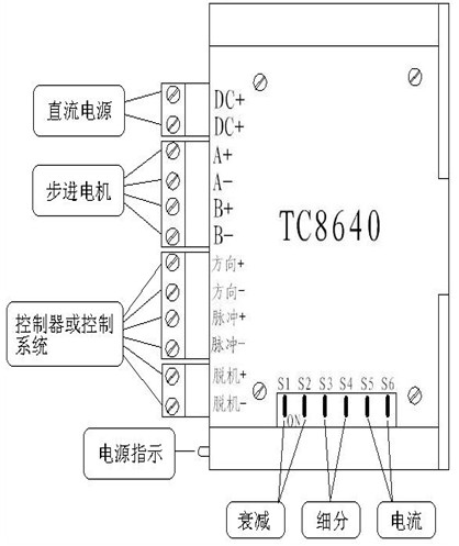

ËÄ¡¢½Ó¿Ú¶¨Òå

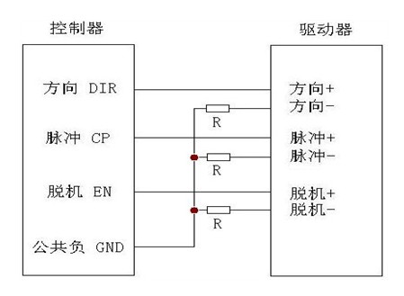

¹²Ñô½ÓÏß¿ØÖÆ·½Ê½
Âö³å+£ºÓÐÂö³åʱ¹¤×÷£¬µÍµçƽÓÐЧ£»ÎÞÂö³åÊÇËø¶¨²¢×Ô¶¯°ëÁ÷¡£
·½Ïò+£ºµÍµçƽÊäÈë»òÐü¿ÕʱÕýת£»¸ßµçƽÊäÈëʱ·´×ª¡£
ÍÑ»ú+£ºµÍµçƽÊäÈë»òÐü¿ÕʱÕý³£¹¤×÷£»¸ßµçƽʱÍÑ»ú¡£

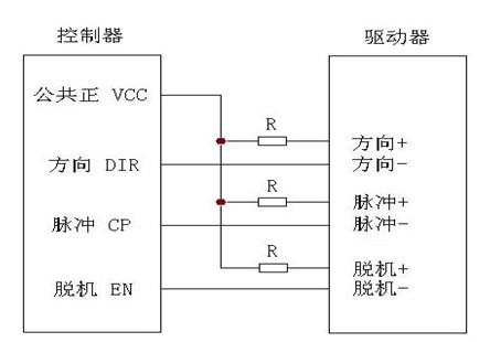

¹²Òõ½ÓÏß¿ØÖÆ·½Ê½
Âö³å£­£ºÓÐÂö³åʱ¹¤×÷£¬¸ßµçƽÓÐЧ£»ÎÞÂö³åÊÇËø¶¨²¢×Ô¶¯°ëÁ÷¡£
·½Ïò£­£º¸ßµçƽÊäÈë»òÐü¿ÕʱÕýת£»µÍµçƽÊäÈëʱ·´×ª¡£
ÍÑ»ú£­£º¸ßµçƽÊäÈë»òÐü¿ÕʱÕý³£¹¤×÷£»µÍµçƽʱÍÑ»ú¡£

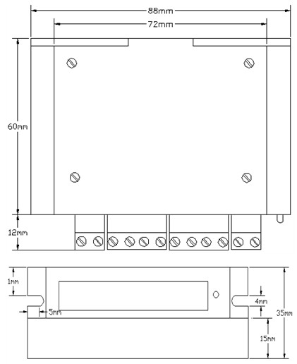

¾Å¡¢ÍâÐγߴç
