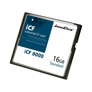

²úÆ·Ãû³Æ£º ÉϺ£ÔìÊ¥INNODISK ICF8000 128M-8G
ÐÍ ºÅ£º
Æ· ÅÆ£º 1520
iCF 8000
EDC/iCF 8000 SeriesΪËÄÐŵÀǶÈëʽ¹Ì̬ӲÅ̵Ĵ¢´æÏµÍ³£¬ÄÜά³ÖÿÃë×î¸ßµ½80MBÓë75MBµÄ¶ÁдËÙ¶È£¬ÇÒÖ§³Ö PIO 0-4/Multiword DMA 0-2/Ultra DMA 0-6 modes¡£
• EDC/iCF 8000 ÔÚÏÖÓвúÆ·Êг¡ÖУ¬²úƷЧÄܱíÏÖ×îºÃ¡£
• µ± EDC 8000 µÄÍâ¹ÛÒÔСģÐÍ·½Ê½³ÊÏÖʱ£¬ÒàÄÜ´ïµ½×îºÃ¼¨Ð§ÇÒÈÝÁ¿Îª16GB¡£
Features
  1. »µÇø¿é¹ÜÀíÓë´íÎóУÕýÂ빦ÄÜ£ºÃ¿512Byte¿ÉУÕý8λԪbits£¬È·±£Êý¾Ý¶ÁÈ¡µÄÕýÈ·ÐÔ£¬Òò¶ø¿É¸ÄÉÆ¹¤Òµ´¢´æÔÚÐÅÏ¢´«ÊäµÄ¿É¿¿¶È¡£
  2. Ôö¼Ó·ÇÕý³£¶ÏµçÊý¾Ý±£»¤¹¦ÄÜ£ºµçÔ´±£»¤µÄ¹¦ÄÜÊÇΪÁËÔÚδԤÆÚ¶Ïµçʱ£¬·ÀÖ¹Êý¾ÝµÄÒâÍâÁ÷ʧÓëË𺦡£
  3. ¾²Ì¬Æ½¾ùĨ³ýËã·¨£º¶ÔÕû¸ö×°ÖõÄÇø¿é×÷ƽ¾ùĨд£¬¼´°üº¬ÁËÔ­±¾³õʼµÄʹÓÃÕßÇø¿éÒÔ¼°¿ÕÏеÄÇø¿éµÈ×÷Ĩд¼°»µÇø¿éµÄÌæ»»¹ÜÀí¶¯×÷¡£Òò´Ë£¬µÃÒÔÌáÉýÕûÌå×°ÖõÄʹÓÃÊÙÃü£¬¶ø¸üÄÜ·ûºÏ¿Í»§ÐèÇóµÄ³É±¾Ð§Òæ¡£
  4. ¶à¹¦ÄÜת»»£ºEDC 8000Ìṩһ¸ö¿ÍÖÆ»¯µÄ½â¾ö·½Ê½£¬¿Í»§¿ÉÒÔÑ¡ÔñʹÓÃÒÔÏÂÁ½ÖֵįäÖÐÒ»ÖÖת»»¹¦ÄÜ£º
      • IDE Master/Slave select
      • д±£»¤
Specifications
Item iCF 8000
ÈÝÁ¿ 2GB~16GB
Ö§³ÖIEDģʽ PIO mode 0-4
MwDMA mode 0-2
UltraDMA mode 0-6
Ö§³Ö½Ó¿Ú 50pin Compact Flash
Êý¾Ý´«ÊäËÙ¶È Read-80 MB/sec.(max.)
Write-75 MB/sec.(max.)
¹¤×÷»·¾³ÎÂ¶È 0¡ãC~+70¡ãC(Standard)/ -40¡ãC~+85¡ãC(Industrial)
´¢´æÎÂ¶È -55¡ãC~+95¡ãC
Õð¶¯(Vibration) 20G(7~2000Hz)
³å»÷(Shock) 1500G/0.5ms
µçÔ´ +3.3V/+5V
ºÄµçÁ¿ 210mA (max.)
³ß´ç 36.4 x 42.8 x 3.3 mm(WxLxH)
SMART¹¦ÄÜÖ§³Ö Support
ATA°²È«¹¦ÄÜÖ§³Ö Support
д±£»¤ Support(optional)
