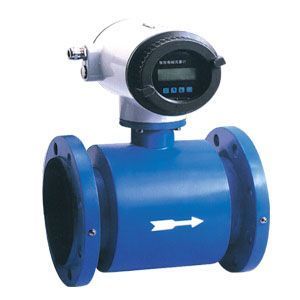

µç´ÅÁ÷Á¿¼Æ²âÁ¿ÔÀíÊÇ·¨ÀµÚµç´Å¸ÐÓ¦¶¨ÂÉ£¬´«¸ÐÆ÷Ö÷Òª×é³É²¿·ÖÊÇ£º²âÁ¿¹Ü¡¢µç¼«¡¢Àø´ÅÏßȦ¡¢ÌúоÓë´Åéî¿ÇÌå¡£ËüÖ÷ÒªÓÃÓÚ²âÁ¿·â±Õ¹ÜµÀÖеĵ¼µçÒºÌåºÍ½¬ÒºÖеÄÌå»ýÁ÷Á¿¡£°üÀ¨Ëá¡¢¼î¡¢ÑεÈÇ¿¸¯Ê´ÐÔµÄÒºÌå¡£ JDLDEϵÁÐ
µç´ÅÁ÷Á¿¼Æ¹ã·ºÓ¦ÓÃÓÚʯÓÍ¡¢»¯¹¤¡¢Ò±½ð¡¢·ÄÖ¯¡¢Ê³Æ·¡¢ÖÆÒ©¡¢ÔìÖ½µÈÐÐÒµÒÔ¼°»·±£¡¢ÊÐÕþ¹ÜÀí£¬Ë®Àû½¨ÉèµÈÁìÓò¡£
²úÆ·ÌØµã£º
£±¡¢²âÁ¿²»ÊÜÁ÷ÌåÃܶȡ¢Õ³¶È¡¢Î¶ȡ¢Ñ¹Á¦ºÍµçµ¼Âʱ仯µÄÓ°Ï죻
£²¡¢²âÁ¿¹ÜÄÚÎÞ×è°Á÷¶¯²¿¼þ£¬ÎÞѹËð£¬Ö±¹Ü¶ÎÒªÇó½ÏµÍ£»
£³¡¢ÏµÁй«³ÆÍ¨¾¶DN15¡«DN3000¡£´«¸ÐÆ÷³ÄÀïºÍµç¼«²ÄÁÏÓжàÖÖÑ¡Ôñ£»
£´¡¢×ª»»Æ÷²ÉÓÃÐÂÓ±Àø´Å·½Ê½£¬¹¦ºÄµÍ¡¢ÁãµãÎȶ¨¡¢¾«È·¶È¸ß¡£Á÷Á¿·¶Î§¶È¿É´ï1500£º1£»
£µ¡¢×ª»»Æ÷¿ÉÓë´«¸ÐÆ÷×é³ÉÒ»ÌåÐÍ»ò·ÖÀëÐÍ£»
£¶¡¢×ª»»Æ÷²ÉÓÃ16λ¸ßÐÔÄÜ΢´¦ÀíÆ÷£¬2x16LCDÏÔʾ£¬²ÎÊýÉ趨·½±ã£¬±à³Ì¿É¿¿£»
£·¡¢Á÷Á¿¼ÆÎªË«Ïò²âÁ¿ÏµÍ³£¬ÄÚ×°Èý¸ö»ýËãÆ÷£ºÕýÏò×ÜÁ¿¡¢·´Ïò×ÜÁ¿¼°²îÖµ×ÜÁ¿£»¿ÉÏÔʾ£®×¯¡¢·´Á÷Á¿£¬²¢¾ßÓжàÖÖÊä³ö£ºµç
Á÷¡¢Âö³å¡¢Êý×ÖͨѶ¡¢HART£»
£¸¡¢×ª»»Æ÷²ÉÓñíÃæ°²×°¼¼Êõ(SMT)£¬¾ßÓÐ×Ô¼ìºÍ×ÔÕï¶Ï¹¦ÄÜ£»
Ö÷Òª¼¼ÊõÊý¾Ý£º
Õû»úºÍ´«¸ÐÆ÷¼¼ÊõÊý¾Ý
