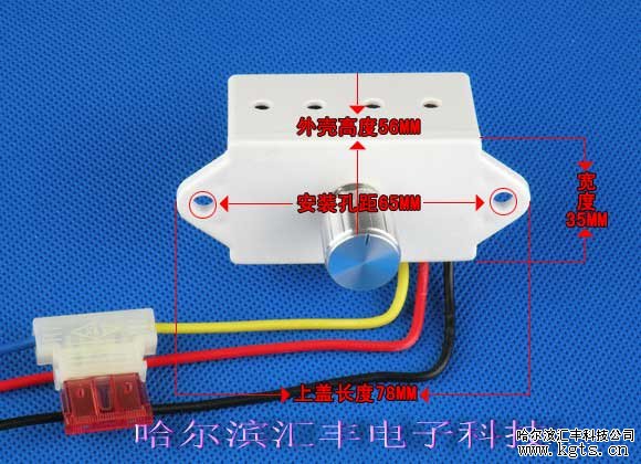

ÍâÐÍÌØµã:³¤·½ÐͰ×É«²ÉÓÃABS¼Ó×èȼ¼Á
ÍâÐͳߴç:³¤78ºÁÃס¢¿í35ºÁÃס¢¸ß56ºÁÃס¢°²×°¿×¾à³¤Îª65ºÁÃ×
 24VÖ±Á÷µ÷ËÙÆ÷
12VÖ±Á÷µ÷ËÙÆ÷¼¼ÊõÖ¸±ê:
(1)¹¤×÷µçѹ:DC6-26V
(2)¿ØÖƹ¦ÂÊ:12Vʱ£¨120W£©¡¢24Vʱ£¨230W£©
(3)¾²Ì¬µçÁ÷0.02A
(4)Æôʹµçѹ:DC0V/0.7V
(5)¶î¶¨µçÁ÷:9A

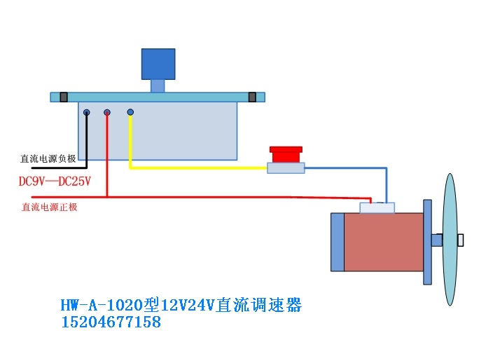

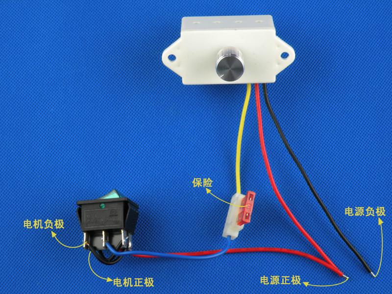

¾ßÌå½ÓÏß·½·¨Çë²Î¿¼£¨Í¼£©ÎÄ×ÖÐðÊöÈçÏÂ.
24VÖ±Á÷µ÷ËÙÆ÷
ʹÓÃ˵Ã÷:µ÷ËÙ¿ª¹ØÓÐÈý¸ö½ÓÏß¶Ë,¾ßÌå½ÓÏß·½·¨ÈçÏÂ,
(1)ºÚÏß½ÓÖ±Á÷µçÔ´¸º¼«,
(2)ºìÏß½ÓÖ±Á÷µçÔ´Õý¼°,
(3)À¶ÏßÓë¸ºÔØµÄ¸º¼«Ïà½Ó,
(4)¸ºÔØÕý¼«½ÓµçÔ´Õý¼«,
×¢Òâ
:½ÓÏß·½Ê½Êô²¢Áª¡£
¼ì²é½ÓÏßÕýÈ·ºó·½¿Éͨµç
½ÓÏßÕýÈ·ºó,ͨµç˳ʱÕëµ÷½ÚÐýŤ,Õâʱ¿ÉÌý¼û»ò¸Ðµ½µ÷ËÙ¿ª¹ØÄÚ²¿ÓÐÇå´àµÄÉùÒô,Õâʱ֤Ã÷ÄÚ²¿¿ª¹ØÒÑ´ò¿ª,Ëæ×ÅÐýŤµÄ½Ç¶È²»¶ÏµÄ¼Ó´ó¿ØÖƵç»úתËÙ²»¶ÏµÄ¼ÓËÙ,
µ±°ÑÐýŤÐýµ½µ×ʱµç»úµÄËÙ¶ÈÒ²´ïµ½×î¸ßËÙ¡£
