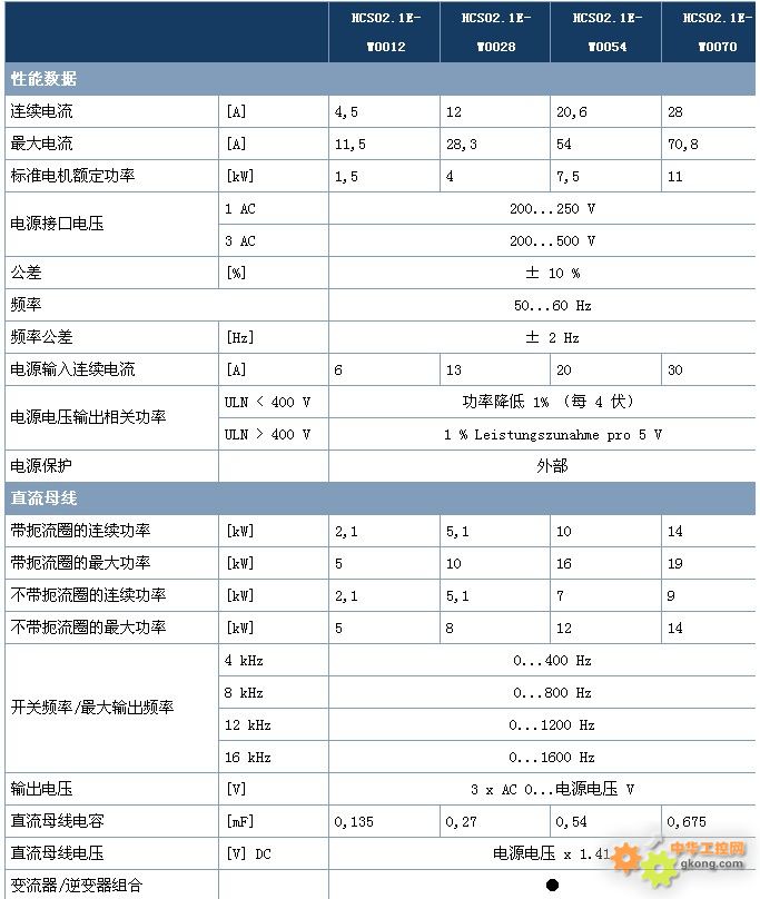

²úÆ·Ãû³Æ£º
µ÷½ÚÆ÷
ÐÍ ºÅ£º
HCS02
0.00
²©ÊÀÁ¦Ê¿ÀÖ(Bosch Rexroth)
»ù±¾×ÊÁÏ
HCS02.1E-W0012 |
HCS02.1E-W0028 |
HCS02.1E-W0054 |
HCS02.1E-W0070 |
| ÐÔÄÜÊý¾Ý |
| Á¬ÐøµçÁ÷ |
[A] |
4,5 |
12 |
20,6 |
28 |
| ×î´óµçÁ÷ |
[A] |
11,5 |
28,3 |
54 |
70,8 |
| ±ê×¼µç»ú¶î¶¨¹¦ÂÊ |
[kW] |
1,5 |
4 |
7,5 |
11 |
| µçÔ´½Ó¿Úµçѹ |
1 AC |
200...250 V |
| 3 AC |
200...500 V |
| ¹«²î |
¡À 10 % |
| ƵÂÊ |
50...60 Hz |
| ƵÂʹ«²î |
[Hz] |
¡À 2 Hz |
| µçÔ´ÊäÈëÁ¬ÐøµçÁ÷ |
[A] |
6 |
13 |
20 |
30 |
| µçÔ´µçѹÊä³öÏà¹Ø¹¦ÂÊ |
ULN < 400 V |
¹¦ÂʽµµÍ 1% £¨Ã¿ 4 ·ü£© |
| ULN > 400 V |
1 % Leistungszunahme pro 5 V |
| µçÔ´±£»¤ |
Íⲿ |
| Ö±Á÷ĸÏß |
| ´ø¶óÁ÷ȦµÄÁ¬Ðø¹¦ÂÊ |
[kW] |
2,1 |
5,1 |
10 |
14 |
| ´ø¶óÁ÷ȦµÄ×î´ó¹¦ÂÊ |
[kW] |
5 |
10 |
16 |
19 |
| ²»´ø¶óÁ÷ȦµÄÁ¬Ðø¹¦ÂÊ |
[kW] |
2,1 |
5,1 |
7 |
9 |
| ²»´ø¶óÁ÷ȦµÄ×î´ó¹¦ÂÊ |
[kW] |
5 |
8 |
12 |
14 |
| ¿ª¹ØÆµÂÊ/×î´óÊä³öƵÂÊ |
4 kHz |
0...400 Hz |
| 8 kHz |
0...800 Hz |
| 12 kHz |
0...1200 Hz |
| 16 kHz |
0...1600 Hz |
| Êä³öµçѹ |
[V] |
3 x AC 0...µçÔ´µçѹ V |
| Ö±Á÷ĸÏßµçÈÝ |
[mF] |
0,135 |
0,27 |
0,54 |
0,675 |
| Ö±Á÷ĸÏßµçѹ |
[V] DC |
µçÔ´µçѹ x 1.41 |
| ±äÁ÷Æ÷/Äæ±äÆ÷×éºÏ |
¡ñ |
HCS02.1E-W0012 |
HCS02.1E-W0028 |
HCS02.1E-W0054 |
HCS02.1E-W0070 |
| ÐÔÄÜÊý¾Ý |
| Á¬ÐøµçÁ÷ |
[A] |
4,5 |
12 |
20,6 |
28 |
| ×î´óµçÁ÷ |
[A] |
11,5 |
28,3 |
54 |
70,8 |
| ±ê×¼µç»ú¶î¶¨¹¦ÂÊ |
[kW] |
1,5 |
4 |
7,5 |
11 |
| µçÔ´½Ó¿Úµçѹ |
1 AC |
200...250 V |
| 3 AC |
200...500 V |
| ¹«²î |
¡À 10 % |
| ƵÂÊ |
50...60 Hz |
| ƵÂʹ«²î |
[Hz] |
¡À 2 Hz |
| µçÔ´ÊäÈëÁ¬ÐøµçÁ÷ |
[A] |
6 |
13 |
20 |
30 |
ULN < 400 V |
| ULN > 400 V |
| µçÔ´±£»¤ |
Íⲿ |
| Ö±Á÷ĸÏß |
| ´ø¶óÁ÷ȦµÄÁ¬Ðø¹¦ÂÊ |
[kW] |
2,1 |
5,1 |
10 |
14 |
| ´ø¶óÁ÷ȦµÄ×î´ó¹¦ÂÊ |
[kW] |
5 |
10 |
16 |
19 |
[kW] |
2,1 |
5,1 |
7 |
9 |
[kW] |
5 |
8 |
12 |
14 |
4 kHz |
0...400 Hz |
| 8 kHz |
0...800 Hz |
| 12 kHz |
0...1200 Hz |
| 16 kHz |
0...1600 Hz |
| Êä³öµçѹ |
[V] |
| Ö±Á÷ĸÏßµçÈÝ |
[mF] |
0,135 |
0,27 |
0,54 |
0,675 |
| Ö±Á÷ĸÏßµçѹ |
[V] DC |
µçÔ´µçѹ x 1.41 |
| ±äÁ÷Æ÷/Äæ±äÆ÷×éºÏ |
¡ñ |
HCS02.1E-W0012 |
HCS02.1E-W0028 |
HCS02.1E-W0054 |
HCS02.1E-W0070 |
| ÐÔÄÜÊý¾Ý |
| Á¬ÐøµçÁ÷ |
[A] |
4,5 |
12 |
20,6 |
28 |
| ×î´óµçÁ÷ |
[A] |
11,5 |
28,3 |
54 |
70,8 |
| ±ê×¼µç»ú¶î¶¨¹¦ÂÊ |
[kW] |
1,5 |
4 |
7,5 |
11 |
| µçÔ´½Ó¿Úµçѹ |
1 AC |
200...250 V |
| 3 AC |
200...500 V |
| ¹«²î |
¡À 10 % |
| ƵÂÊ |
50...60 Hz |
| ƵÂʹ«²î |
[Hz] |
¡À 2 Hz |
| µçÔ´ÊäÈëÁ¬ÐøµçÁ÷ |
[A] |
6 |
13 |
20 |
30 |
ULN < 400 V |
| ULN > 400 V |
| µçÔ´±£»¤ |
Íⲿ |
| Ö±Á÷ĸÏß |
| ´ø¶óÁ÷ȦµÄÁ¬Ðø¹¦ÂÊ |
[kW] |
2,1 |
5,1 |
10 |
14 |
| ´ø¶óÁ÷ȦµÄ×î´ó¹¦ÂÊ |
[kW] |
5 |
10 |
16 |
19 |
[kW] |
2,1 |
5,1 |
7 |
9 |
[kW] |
5 |
8 |
12 |
14 |
4 kHz |
0...400 Hz |
| 8 kHz |
0...800 Hz |
| 12 kHz |
0...1200 Hz |
| 16 kHz |
0...1600 Hz |
| Êä³öµçѹ |
[V] |
| Ö±Á÷ĸÏßµçÈÝ |
[mF] |
0,135 |
0,27 |
0,54 |
0,675 |
| Ö±Á÷ĸÏßµçѹ |
[V] DC |
µçÔ´µçѹ x 1.41 |
| ±äÁ÷Æ÷/Äæ±äÆ÷×éºÏ |
¡ñ |
