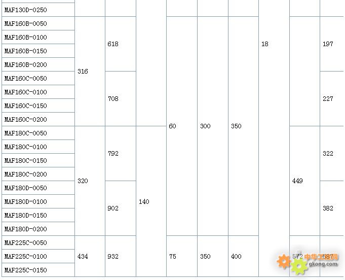

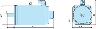

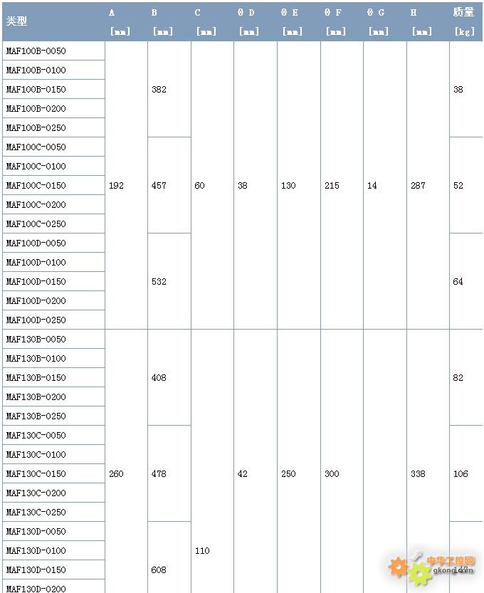

ÐͺŹæ¸ñ
ÀàÐÍ |
A |
B |
C |
Ø D |
Ø E |
Ø F |
Ø G |
H |
ÖÊÁ¿ |
[mm] |
[mm] |
[mm] |
[mm] |
[mm] |
[mm] |
[mm] |
[mm] |
[kg] |
MAF100B-0050 |
192 |
382 |
60 |
38 |
130 |
215 |
14 |
287 |
38 |
MAF100B-0100 |
MAF100B-0150 |
MAF100B-0200 |
MAF100B-0250 |
MAF100C-0050 |
457 |
52 |
MAF100C-0100 |
MAF100C-0150 |
MAF100C-0200 |
MAF100C-0250 |
MAF100D-0050 |
532 |
64 |
MAF100D-0100 |
MAF100D-0150 |
MAF100D-0200 |
MAF100D-0250 |
MAF130B-0050 |
260 |
408 |
110 |
42 |
250 |
300 |
18 |
338 |
82 |
MAF130B-0100 |
MAF130B-0150 |
MAF130B-0200 |
MAF130B-0250 |
MAF130C-0050 |
478 |
106 |
MAF130C-0100 |
MAF130C-0150 |
MAF130C-0200 |
MAF130C-0250 |
MAF130D-0050 |
608 |
147 |
MAF130D-0100 |
MAF130D-0150 |
MAF130D-0200 |
MAF130D-0250 |
MAF160B-0050 |
316 |
618 |
60 |
300 |
350 |
197 |
MAF160B-0100 |
MAF160B-0150 |
MAF160B-0200 |
MAF160C-0050 |
708 |
227 |
MAF160C-0100 |
MAF160C-0150 |
MAF160C-0200 |
MAF180C-0050 |
320 |
792 |
140 |
449 |
322 |
MAF180C-0100 |
MAF180C-0150 |
MAF180C-0200 |
MAF180D-0050 |
902 |
382 |
MAF180D-0100 |
MAF180D-0150 |
MAF180D-0200 |
MAF225C-0050 |
434 |
932 |
75 |
350 |
400 |
572 |
587 |
MAF225C-0100 |
MAF225C-0150 |
