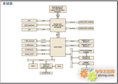

ÑлªPCA-6008 79 Õë Pentium ® M SBC´øVGA/DVI/˫ǧÕ×Íø¿Ú¹¤¿ØÖ÷°å
ÌØÐÔ
¡ñ Socket 479 Pentiu® m M´¦ÀíÆ÷£¬Ö§³Ö533 MHz FSB
¡ñ Ö§³Ö˫ͨµÀDDR2 533/400 SDRAM£¬×î¸ß¿É´ï2 GB
¡ñ ͨ¹ý2¸öPCIe x1²å²ÛÖ§³Ö˫ǧÕ×ÒÔÌ«Íø
¡ñ 2¸öSATA½Ó¿Ú
¡ñ 6¸öCOM¶Ë¿Ú
¡ñ 8¸öUSB 2.0½Ó¿Ú
¹æ¸ñ
´¦ÀíÆ÷ϵͳ
CPU Intel Pentium M Celeron M Celeron M
×î¸ßÖ§³ÖËÙ¶È2.26 GHz 1.7 GHz °åÔØ600 MHz(½öÊÊÓÃÓÚPCA-6008VG-06A1E)
¶þ¼¶»º´æ512 KB, 1 MB, 2 MB оƬ×éIntel 915GME + ICH6M 910GMLE + ICH6M BIOS Award 4 Mbit FWH FSBǰ¶Ë×ÜÏß533/400 MHz 400 MHz
ϵͳ×ÜÏß
PCI 32-bit/33 MHz PCI ISA HISA (ISA High Driver)
ÄÚ´æ
¹æ·¶Ë«Í¨µÀDDR2 533/400 MHz DIMM ×î´ó¿ÉÖ§³ÖÈÝÁ¿2 GB
²å²Û240ÕëDIMM x 2
ÏÔʾоƬ
¿ØÖÆÆ÷оƬ×鼯³ÉVGA¿ØÖÆÆ÷ VRAM ¹²ÏíϵͳÄڴ棬×î¸ß¿É´ï128 MB
LVDS µ¥Í¨µÀ18-bit/˫ͨµÀ36-bit LVDS ÊÓÆµÊä³ö15ÕëCRT½Ó¿Úx1/(¿ÉÑ¡ DVI ½Ó¿Ú)
ÒÔÌ«Íø
ÍøÂç½çÃæ10/100/1000 Mbps ¿ØÖÆÐ¾Æ¬RTL8111B Á¬½Ó¶Ë¿ÚRJ-45 ´øLED ½Ó¿Ú x 2
EIDE
ģʽATA 100/66/33 ͨµÀ1 (×î¶à¿ÉÖ§³Ö2¸ö IDEÉ豸)
SATA
(150MB/s) ½Ó¿Ú2¸ö
I/O½Ó¿Ú
USB 8¸ö½Ó¿Ú (·ûºÏUSB 2.0/1.1±ê×¼) £¬ÅÅÕë; 4¸ö½Ó¿Ú (·ûºÏUSB 2.0/1.1±ê×¼)´®¿Ú5 (RS-232)/1 (RS-232/RS-422/RS-485) £¬ÓÐÅÅÕë; 2 (RS-232)²¢¿Ú1 (EPP/ECP/SPP) FDD 1PS/2 1 (ÓÃÓÚÊó±êºÍ¼üÅÌ£¬°ü×°Öк¬ÓÐYÐ͵çÀÂ)
¿´ÃŹ·¶¨Ê±Æ÷
Êä³öϵͳ¸´Î» ¼ä¸ô¿É±à³Ì1-255 sec
ÆäËû¹¦ÄÜ
ÒôƵÊä³öAC97ÒôƵ½Ó¿Ú (ÒªÇóÒôƵÀ©Õ¹Ä£¿éP/N: PCA-AUDIO-00A1E)
µçÔ´
CPU ÅäÖÃ1: Pentium M´¦ÀíÆ÷780 (2.26 GHz/27 W) + DDR2 2 GB
µçѹ+12 V +5 V +3.3 V +5 VSB -12 V -5
µçÁ÷3.09 A 4.26 A 0 A 0.42 A 0 A 0 A
CPU ÅäÖÃ2: Celeron M´¦ÀíÆ÷600 MHz/7 W + DDR2 2 GB
µçѹ+12 V +5 V +3.3 V +5 VSB -12 V -5V
µçÁ÷0.56 A 3.66 A 0 A 0.07 A 0 A 0 A
»·¾³
ÎÂ¶È ¹¤×÷״̬·Ç¹¤×÷״̬ (´¢´æ)0 ~ 60¡æ (32 ~ 140¡£F)
(¹¤×÷ʪ¶È: 40¡æ@85% RH ·ÇÄý½á)-40¡æ ~ 85¡æºÍ60¡æ @ 95% RH
·ÇÄý½á
Íâ¹Û³ß´ç£¨W x D£© 338 mm (L) x 122 mm (W) (13.3" x 4.8")
¶©¹ºÐÅÏ¢
ÐͺŠPCA-6008G2-00A1E  CPU Socket   ±±ÇÅ 915GME  LVDSÓÐ  DVIÓÐ  VGAÓР ǧÕ×Íø¿Ú Ë«   USB 8  COM 6   CF ÓÐ
ÐͺŠPCA-6008VG-06A1E  CPU Celeron M600M/512  ±±ÇÅ 910GMLE LVDS -  DVI-  VGAÓР ǧÕ×Íø¿Ú µ¥   USB 4  COM 2   CF ¨C
