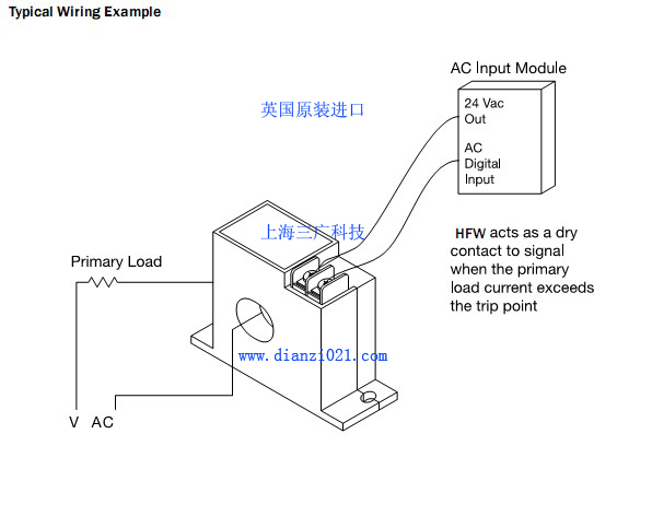

Description
The HFW series of AC current switches activate a normally open (NO) contact closure via a solid-state switch whenever the monitored primary circuit current exceeds a pre-set level. Models are available to switch various load types, feature integral LEDs to indicate device power and also the switch status and can be provided in solid or split core configurationThe HFW-Axx models include a multi-turn adjustment to set the trip threshold to the desired value and the HFW-Fxx models operate as a go/no-go status indicators with a factory set minimum threshold value.The switches can monitor up to 200 Amps continuous and feature an auto-rangecircuit to eliminate manual   jumpers. All models are UL, CE and RoHS compliant.The HFW series current switches are accurate, reliable, easy to install and require less servicing than differential pressure switches, or flow switches.  The HFW series current switches can be used to monitor devices with a maximum continuous operating current of up to 2 0 0 Amps and the power supply is induced from the conductor being monitored. All of these units come with anunconditional 5 year limited warranty.
Features
  • Auto-ranging up to 200A
  • Power induced from monitored conductor
  • True digital switching and very low leakage
  • Small compact size
  • Easy field adjustment with status LED¡¯s
  • Choice of output rating
  • Fixed or adjustable setpoint
  • Five Year Warranty
Specification Guide
Power Supply:                   None !a self-powere
Setpoint:                             Solid core - 0.5A...200A
                                            Split core - 1.5A...200A
Output Switch:                   Solid state 0.3A @ 135V ac/dc
                                                       1A @ 250Vac
Hysteresis:                        < 2% FS max.
Response Time:                < 200 mS
Enclosure Size:                Solid core - 61 x 90 x 25 mm
                                           Split core - 63 x 100 x 32 mm
Conductor Hole Size:      Solid core - 19mm diameter
                                           Split core - 22.6 x 22.6 mm
Operating Temperature: ¡§C25!aC to + 70  CE, UL and RoHS
