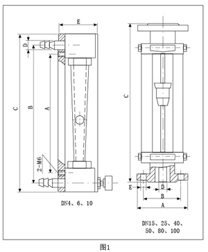

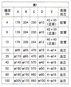

ÍâÐμ°°²×°³ß´ç

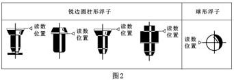

Á÷Á¿¼ÆÖи¡×Ó¶ÁÊýλÖð´Í¼2Ëùʾ:

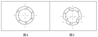

LZB/LZB-( )FÁ÷Á¿¼ÆµÄ×¶¹ÜΪ¹â»¬ÄÚ±Ú¹Ü(¼ûͼ4)£¬Í¨¾¶DN15ÒÔÉϵÄÁ÷Á¿¼Æ£¬¸¡×Óͨ¹ýµ¼¸Ë ÉÏÏÂÒÆ¶¯£¬±£³ÖÎȶ¨£»LZJ/LZJ-( )FÁ÷Á¿¼Æ×¶¹Ü ÄÚ±ÚÓÐÈýÌõµ¼Ïò͹½î£¬Ê¹¸¡×Ó±£³ÖÎȶ¨(¼ûͼ4)¡£Í¨¾¶DN10ÒÔϵÄÁ÷Á¿¼Æ²ÉÓÃÈí¹ÜÁ¬½Ó£¬ÅäÓÐ ÕëÐÎÁ÷Á¿µ÷½Ú·§£»Í¨¾¶DN15ÒÔÉÏÁ÷Á¿¼Æ²ÉÓ÷¨À¼Á¬½Ó¡£

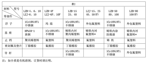

½Ó´¥²âÁ¿Á÷ÌåµÄÁ㲿¼þ²ÄÖÊ

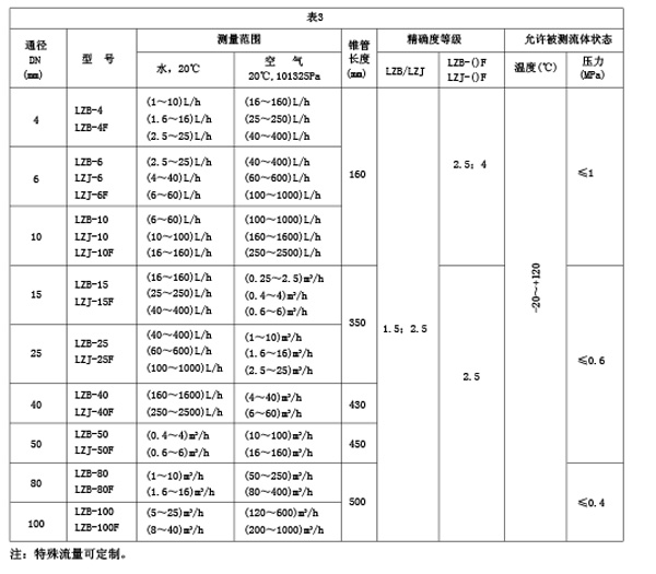

²£Á§×ª×ÓÁ÷Á¿¼ÆÐͺŹæ¸ñ¼°¼¼Êõ²ÎÊý
È«²»Ðâ¸ÖÐÍ
·¨À¼¡¢¸¡×Ó¡¢µ¼¸Ë¡¢Ö§³Ð°å¼°ÂÝ˨µÈ¾ùΪ²»Ðâ¸Ö304£¨1Cr18Ni9Ti),ÐͺÅΪLZB-( )B¡£
½ÓÒº²ÄÖÊÈçÐèÑ¡ÓÃ316£¬ÔòÐͺÅΪLZB-( )Bo£¬Ð趨×ö¡£
ÈçÐè²»Ðâ¸ÖÄÚ³ÄPTFE£¬ÔòÐͺÅΪLZB-( )BF(»òBoF),Ð趨×ö¡£
È«ËÄ·úÐÍ
»ù×ù¡¢¸¡×Ó¡¢Õë·§²ÉÓþÛËÄ·úÒÒÏ©£¨PTTFE)¡£Ö§³Ð°å¡¢ÂÝË¿µÈ²ÉÓò»Ðâ¸Ö
