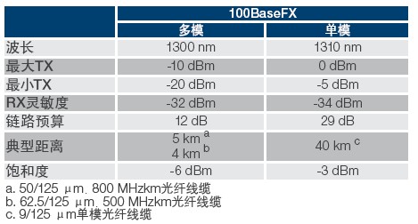

¼¼Êõ²ÎÊý ±ê×¼£º IEEE 802.3ÊÊÓÃÓÚ10BaseT IEEE 802.3uÊÊÓÃÓÚ100BaseT£¨X£©and 100BaseFX IEEE 802.3xÊÊÓÃÓÚFlow Control IEEE 802.1D-2004ÊÊÓÃÓÚSpanning Tree Protocol IEEE 802.1wÊÊÓÃÓÚRapid STP IEEE 802.1pÊÊÓÃÓÚClass of Service IEEE 802.1QÊÊÓÃÓÚVLAN Tagging ÐÒ飺IGMPv1/v2£¬GMRP£¬GVRP£¬SNMPv1/v2c/v3£¬DHCP Server/Client£¬TFTP£¬SNTP£¬SMTP£¬RARP£¬RMON£¬HTTP£¬Telnet£¬Syslog£¬DHCP Option 66/67/82£¬BootP£¬LLDP£¬EtherNet/IP£¬Modbus/TCP£¬IPv6£¬NTP Server/Client MIB£ºMIB-II£¬Ethernet-Like MIB£¬P-BRIDGE MIB£¬Bridge MIB£¬RSTP MIB£¬RMON MIB Group 1£¬2£¬3£¬9 Á÷Á¿¿ØÖÆ£ºIEEE802.3xÁ÷¿Ø£¬±³Ñ¹Ê½Á÷¿Ø ½»»»»úÊôÐÔ MACµØÖ·±í´óС£º2 K£¨EDS-405A£©£¬8 K£¨EDS-408A£© ·â°ü»º³åÇø´óС£º1 Mbit ½Ó¿Ú ¹âÏ˽ӿڣº100BaseFX ports£¨SC/ST½Ó¿Ú£© RJ45¶Ë¿Ú£º10/100BaseT£¨X£©×Ô¶¯ÐÉÌËÙ¶È£¬È«/°ëË«¹¤Ä£Ê½£¬ºÍ×Ô¶¯MDI/MDI-XÁ¬½Ó ¿ØÖƿڣºRS-232£¨RJ45½Ó¿Ú£© DIP¿ª¹Ø£ºTurbo Ring£¬Master£¬Coupler£¬Reserve LEDָʾµÆ£ºPWR1£¬PWR2£¬FAULT£¬MSTR/HEAD£¬CPLR/TAIL£¬10/100M ±¨¾¯Êä³ö£ºÒ»Â·¼ÌµçÆ÷Êä³ö£¬µçÁ÷¸ºÔØÄÜÁ¦1 A @ 24 VDC ¹âÏË  µçÔ´ÐèÇó ÊäÈëµçѹ£º24 VDC£¨12 ~ 45 VDC£©£¬Ë«ÈßÓàÊäÈë ÊäÈëµçÁ÷£º EDS-405A£º0.24 A @ 24 V EDS-405A-MM/SS£º0.32 A @ 24 V EDS-408A£º0.26 A @ 24 V EDS-408A-MM/SS£º0.35 A @ 24 V EDS-408A-3M/3S/2M1S/1M2S£º0.32 A @ 24 V ¹ýÔØ±£»¤£ºÌṩ ½Ó¿Ú£º1¸ö¿É²å°ÎµÄ6Õë½ÓÏß¶Ë×Ó ·´½Ó±£»¤£ºÌṩ »úÐµÌØÐÔ Íâ¿Ç£º½ðÊô£¬IP30·À»¤µÈ¼¶ ³ß´ç£º53.6 x 135 x 105 mm£¨2.11 x 5.31 x 4.13 in£© ÖØÁ¿£º EDS-405A£¬EDS-405A-MM£¬EDS-405A-SS£º650 g EDS-408A£¬EDS-408A-MM£¬EDS-408A-SS£º650 g EDS-408A-3M/3S/2M1S/1M2S£º890 g °²×°·½Ê½£ºµ¼¹ì¡¢±Ú¹Ò£¨¿ÉÑ¡Ì×¼þ£© ¹¤×÷»·¾³ ¹¤×÷ζȣº ±ê×¼Ðͺţº0 ~ 60 ¡ãC£¨32 ~ 140 ¡ãF£© ¿íÎÂÐͺţº-40 ~ 75 ¡ãC£¨-40 ~ 167 ¡ãF£© ´æ´¢Î¶ȣº-40 ~ 85 ¡ãC£¨-40 ~ 185 ¡ãF£© Ïà¶Ôʪ¶È£º5 ~ 95%£¨ÎÞÄý¶£© °²¹æÈÏÖ¤ Safety£ºUL 508£¬UL 60950-1*£¬CSA C22.2 No.60950-1£¬EN 60950-1** Hazardous Location£ºUL/cUL Class I Division 2 Groups A/B/C/D*£¬ATEX Zone 2 Ex nC IIC* EMI£ºFCC Part 15 Subpart B Class A£¬EN 55022 Class A EMS£º EN 61000-4-2£¨ESD£©Level 3£¬EN 61000-4-3£¨RS£©Level 3£¬ EN 61000-4-4£¨EFT£©Level 3£¬EN 61000-4-5£¨Surge£©Level 3£¬ EN 61000-4-6£¨CS£©Level 3£»EN 61000-4-8 Marine£º EDS-405A£¬EDS-405A-MM£¬EDS-405A-SS£ºDNV£¬GL EDS-408A£¬EDS-408A-MM£¬EDS-408A-SS£ºDNV£¬GL EDS-408A-3M/3S/2M1S/1M2S£ºDNV£¬GL£¬LR£¬ABS£¬NK Rail Traffic£ºEN 50121-4** Shock£ºIEC 60068-2-27 Freefall£ºIEC 60068-2-32 Vibration£ºIEC 60068-2-6 *EDS-405A£¬EDS-405A-MM/SS£¬EDS-408A£¬EDS-408A-MM/SSϵÁÐ **½öEDS-408AϵÁÐ MTBF£¨Æ½¾ùÎÞ¹ÊÕÏʱ¼ä£©£º EDS-405AϵÁУº392£¬000Сʱ EDS-408AϵÁУº363£¬000Сʱ Êý¾Ý¿â£ºTelcordia£¨Bellcore£©£¬GB ±£ÐÞ ±£ÐÞÆÚ£º5Äê
