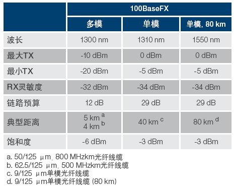

IEEE 802.3uÊÊÓÃÓÚ100BaseT£¨X£©and 100BaseFX

½Ó¿Ú ¹âÏ˽ӿڣº100BaseFX¿Ú£¨SC/ST½Ó¿Ú£©
