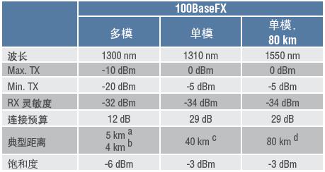

Moxa CM-600ϵÁÐΪEDS-600Ä£¿é»¯ÒÔÌ«Íø½»»»»úÌṩÁ˷ḻµÄ¹¤ÒµÒÔÌ«Íø½Ó¿ÚÄ£¿éÑ¡Ôñ¡£ÓжàÖÖÍ­»ò¹âÏË£¨SC/ST£©½ÓÍ·µÄ4¿Ú¸ßËÙÒÔÌ«ÍøÄ£¿é¿ÉÑ¡£¬ÏíÊܸü¸ßµÄÁé»îÐÔÓëÀ©Õ¹ÐÔ¡£Óû§¿É·½±ãµØÕë¶Ô¸÷×ÔµÄÌØ¶¨Ó¦Óã¬ÉèÖöàÑù»¯µÄÁ¬½Ó·½°¸¡£
½Ó¿Ú ¹âÏ˽ӿڣº 100BaseFX(SC/ST½ÓÍ·)
RJ45¶Ë¿Ú£º 10/100BaseT(X)×ÔÕì²â£¬È«/°ëË«¹¤£¬
×Ô¶¯MID/MID-XÁ¬½Ó
LEDָʾµÆ£º TP¶Ë¿Ú10/100£¬¹âÏ˶˿Ú100M
¹âÏË
a. 50/125 ¦Ìm, 800 MHz*km ¹âÀÂ
b. 62.5/125 ¦Ìm, 500 MHz*km ¹âÀÂ
c. 9/125 ¦Ìm µ¥Ä£¹âÀÂ
d. 9/125 ¦Ìm µ¥Ä£¹âÀ (80 km)
