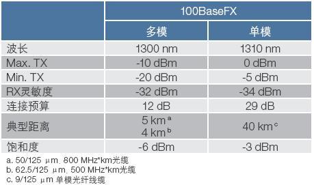

¼¼Êõ²ÎÊý ±ê×¼£ºIEEE802.3£¬802.3u£¬802.3x£¬802.1D£¬802.1W£¬
802.1Q£¬802.1p £¬802.1X£¬802.3ad

½Ó¿Ú RJ45½Ó¿Ú£º10/100BaseT(X) ×ÔÊÊÓ¦£¬È«/°ëË«¹¤ºÍMDI/ MDI-X×ÔÊÊÓ¦
¹âÏ˽ӿڣº100BaseFX¿Ú (SC/ST½Ó¿Ú)

¹âÏË
