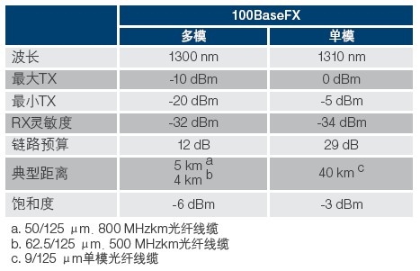

¼¼Êõ²ÎÊý ±ê×¼£º IEEE 802.3ÊÊÓÃÓÚ10BaseT IEEE 802.3uÊÊÓÃÓÚ100BaseT£¨X£©and 100BaseFX IEEE 802.3xÊÊÓÃÓÚFlow Control ´¦ÀíÀàÐÍ£º´æ´¢ºÍת·¢ Á÷¿Ø£ºIEEE802.3xȫ˫¹¤£¬±³Ñ¹Ê½Á÷¿Ø ½»»»»úÊôÐÔ MACµØÖ·±í´óС£º1 K ·â°ü»º³åÇø´óС£º512 Kbit ½Ó¿Ú ¹âÏ˽ӿڣº100BaseFX¶Ë¿Ú£¨SC/ST½Ó¿Ú£© RJ45¶Ë¿Ú£º10/100BaseT£¨X£©×Ô¶¯Õì²â£¬È«/°ëË«¹¤£¬MDI/MDI-X×ÔÊÊÓ¦ DIP¿ª¹Ø£ºÆôÓÃ/½ûÓù㲥·ç±©±£»¤ LEDָʾµÆ£ºPower£¬10/100M£¨TP¶Ë¿Ú£©£¬100M£¨¹â¿Ú£© ¹âÏË  µçÔ´ÐèÇó ÊäÈëµçѹ£º12/24/48 VDC£¨9.6 ~ 60 VDC£©£¬18 ~ 30 VAC£¨47 ~ 63 Hz£©£¬ÈßÓàË«µçÔ´ÊäÈë ÊäÈëµçÁ÷£º EDS-205A£º0.1 A @ 24 V EDS-205A-M/S£º0.11 A @ 24 V EDS-208A£º0.13 A @ 24 V EDS-208A-M£º0.17 A @ 24 V EDS-208A-MM/SS£º0.22 A @ 24 V ¹ýÔØµçÁ÷±£»¤£º1.1 A ½Ó¿Ú£º1¸ö¿É²å°ÎµÄ4Õë½ÓÏß¶Ë×Ó ·´½Ó±£»¤£ºÖ§³Ö »úÐµÌØÐÔ °ü×°£ºÂÁÖÆÍâ¿Ç£¬IP30·À»¤ ³ß´ç£º EDS-205A£º30 x 115 x 70 mm£¨1.18 x 4.52 x 2.76 in£© EDS-208A£º50 x 115 x 70 mm£¨1.96 x 4.52 x 2.76 in£© ÖØÁ¿£º EDS-205A£º175 g EDS-208A£º275 g °²×°£ºµ¼¹ì¡¢±Ú¹Ò°²×°£¨¿ÉÑ¡Ì×¼þ£© ¹¤×÷»·¾³ ¹¤×÷ζȣº ±ê×¼Ðͺţº-10 ~ 60 ¡ãC£¨14 ~ 140 ¡ãF£© ¿íÎÂÐͺţº-40 ~ 75 ¡ãC£¨-40 ~ 167 ¡ãF£© ´æ´¢Î¶ȣº-40 ~ 85 ¡ãC£¨-40 ~ 185 ¡ãF£© Ïà¶Ôʪ¶È£º5 ~ 95%£¨ÎÞÄý¶£© °²¹æÈÏÖ¤ Safety£ºUL 508 Hazardous Location£ºUL/cUL Class I Division 2 Groups A/B/C/D£¬ATEX Zone 2 Ex nC IIC EMI£ºFCC Part 15 Subpart B Class A£¬EN 55022 Class A EMS£º EN 61000-4-2£¨ESD£©Level 3£¬EN 61000-4-3£¨RS£©Level 3£¬ EN 61000-4-4£¨EFT£©Level 3£¬EN 61000-4-5£¨Surge£©Level 3£¬ EN 61000-4-6£¨CS£©Level 3£¬EN 61000-4-8£¬EN 61000-4-11 Marine£ºDNV£¬GL£¬LR£¬ABS£¬NK Wheeled Vehicles£ºe-Mark£¨E1£©£¨½öEDS-208A£© Rail Traffic£ºEN 50121-4 Shock£ºIEC 60068-2-27 Freefall£ºIEC 60068-2-32 Vibration£ºIEC 60068-2-6 MTBF£¨Æ½¾ùÎÞ¹ÊÕÏʱ¼ä£©£º425£¬000Сʱ Êý¾Ý¿â£ºTelcordia£¨Bellcore£©£¬GB ±£ÐÞ ±£ÐÞÆÚ£º5Äê
