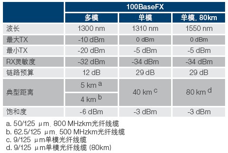

¼¼Êõ²ÎÊý ±ê×¼£º IEEE 802.3ÊÊÓÃÓÚ10BaseT IEEE 802.3uÊÊÓÃÓÚ100BaseT£¨X£©and 100BaseFX IEEE 802.3xÊÊÓÃÓÚFlow Control ´¦ÀíÀàÐÍ£º´æ´¢ºÍת·¢ Á÷¿Ø£ºIEEE802.3xȫ˫¹¤£¬±³Ñ¹Ê½Á÷¿Ø ½»»»»úÊôÐÔ MACµØÖ·±í´óС£º1 K£¨EDS-305/308/309£© ·â°ü»º³åÇø´óС£ºn/a£¨EDS-305£©£¬512 Kbit£¨EDS-308/305£© ½Ó¿Ú ¹âÏ˽ӿڣº100BaseFX¶Ë¿Ú£¨SC/ST½Ó¿Ú£© RJ45¶Ë¿Ú£º10/100BaseT£¨X£©×Ô¶¯Õì²â£¬È«/°ëË«¹¤£¬MDI/MDI-X×ÔÊÊÓ¦ DIP¿ª¹Ø£ºÆôÓÃ/½ûÓù㲥·ç±©±£»¤ LEDָʾµÆ£ºPWR1£¬PWR2£¬FAULT£¬10/100M£¨TP¿Ú£©£¬100M£¨¹â¿Ú£© ±¨¾¯Êä³ö£ºÒ»Â·¼ÌµçÆ÷Êä³ö±¨¾¯£¬1A @ 24 VDC ¹âÏË µçÔ´ÐèÇó ÊäÈëµçѹ£º EDS-305/308£º24 VDC£¨12 ~ 48 VDC£©£¬Ë«ÈßÓàÊäÈë ÊäÈëµçÁ÷£º EDS-305£º0.13 A @ 24 V EDS-305-M/S£º0.17 A @ 24 V EDS-308£º0.13 A @ 24 V EDS-308-M/S£º0.21 A @ 24 V EDS-308-MM/SS£º0.26 A @ 24 V ¹ýÔØµçÁ÷±£»¤£º EDS-305£¬EDS-305-M£¬EDS-305-S£¬EDS-308£º1.1 A EDS-308-M/S/MM/SS£º1.6 A ½Ó¿Ú£º1¸ö¿É²å°ÎµÄ6Õë½ÓÏß¶Ë×Ó ·´½Ó±£»¤£ºÌṩ »úÐµÌØÐÔ °ü×°£º½ðÊôÍâ¿Ç£¬IP30·À»¤ ³ß´ç£º EDS-305/308/309ϵÁУº 53.6 x 135 x 105 mm£¨2.11 x 5.31 x 4.13 in£© ÖØÁ¿£º EDS-305/308/309ϵÁУº630 g °²×°£ºµ¼¹ì¡¢±Ú¹Ò°²×°£¨¿ÉÑ¡Ì×¼þ£© ¹¤×÷»·¾³ ¹¤×÷ζȣº ±ê×¼Ðͺţº0 ~ 60 ¡ãC£¨32 ~ 140 ¡ãF£© ¿íÎÂÐͺţº-40 ~ 75 ¡ãC£¨-40 ~ 167 ¡ãF£© ´æ´¢Î¶ȣº-40 ~ 85 ¡ãC£¨-40 ~ 185 ¡ãF£© Ïà¶Ôʪ¶È£º5 ~ 95%£¨ÎÞÄý¶£© °²¹æÈÏÖ¤ Safety£º EDS-305ϵÁУºUL 508£¬UL 60950-1£¬CSA C22.2 No. 60950-1 EDS-308£ºUL 508£¬UL 60950-1£¬CSA C22.2 No. 60950-1£¬EN 60950-1 Hazardous Location£ºUL/cUL Class I Division 2 Groups A/B/C/D£¬ATEX Zone 2 Ex nC IIC EMI£ºFCC Part 15 Subpart B Class A£¬EN 55022 Class A EMS£º EN 61000-4-2£¨ESD£©Level 3£¬EN 61000-4-3£¨RS£©Level 3£¬ EN 61000-4-4£¨EFT£©Level 3£¬EN 61000-4-5£¨Surge£©Level 3£¬ EN 61000-4-6£¨CS£©£¨EDS-305/308£ºLevel 2£»EDS-309/316£ºLevel 3£© Marine£ºDNV£¬GL Shock£ºIEC 60068-2-27 Freefall£ºIEC 60068-2-32 Vibration£ºIEC 60068-2-6 MTBF£¨Æ½¾ùÎÞ¹ÊÕÏʱ¼ä£©£º EDS-305ϵÁУº422£¬000Сʱ EDS-308ϵÁУº255£¬000Сʱ Êý¾Ý¿â£ºMIL-HDBK-217F£¬GB ±£ÐÞ ±£ÐÞÆÚ£º5Äê
