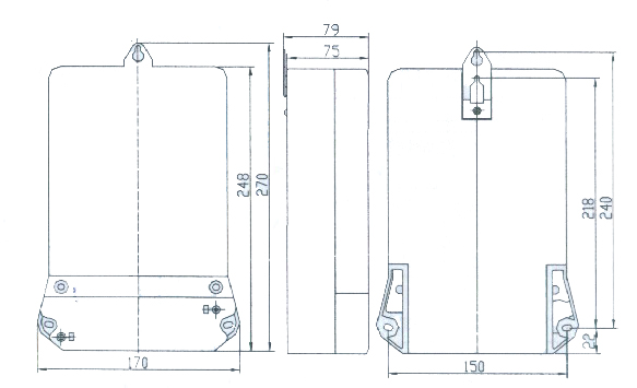

ËÄ.ÍâÐγߴ缰½ÓÏßͼ£º
    ÍâÐγߴ磺270mm*170mm*79mm  °²×°³ß´ç£º240mm*150  mm
